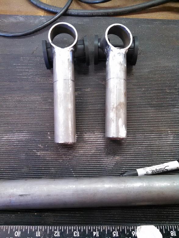

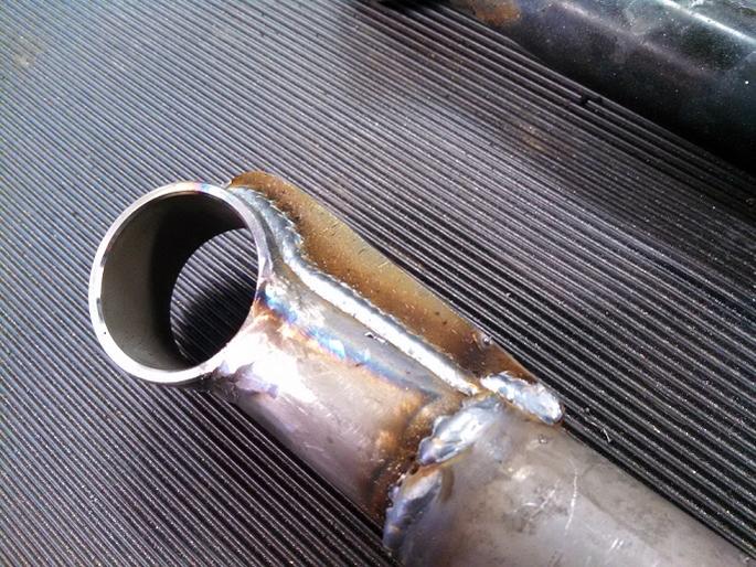

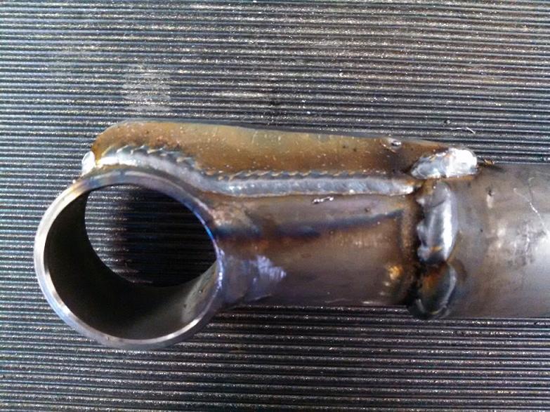

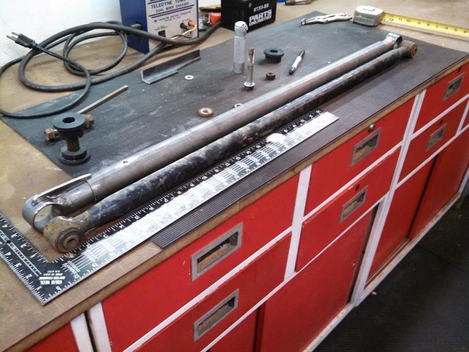

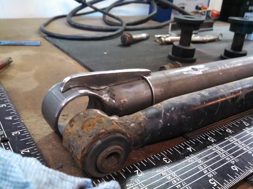

It's time to start another project on the truck. A little while back the panhard bar started making some noise from a little bit of play in the bushing. I attempted to tighten the bolt up and it was a temporary fix. Instead of spending the money to buy a fancy adjustable bar, I decided to get some building parts from ruffstuffspecialities and fab up my own bar.
What I used was : 1.5x.120 DOM tubing for the main tube, 1.25x.120 DOM to sleeve inside the main bar on either end to better adapt to the custom width poly bushings on either end. And just some scrap 3/8" angle steel to make the gusset. Simple design and a practice run when it comes time to make stronger lower links.
Once it is all welded up painted and installed I'll post more pictures.
But for now here are a few...

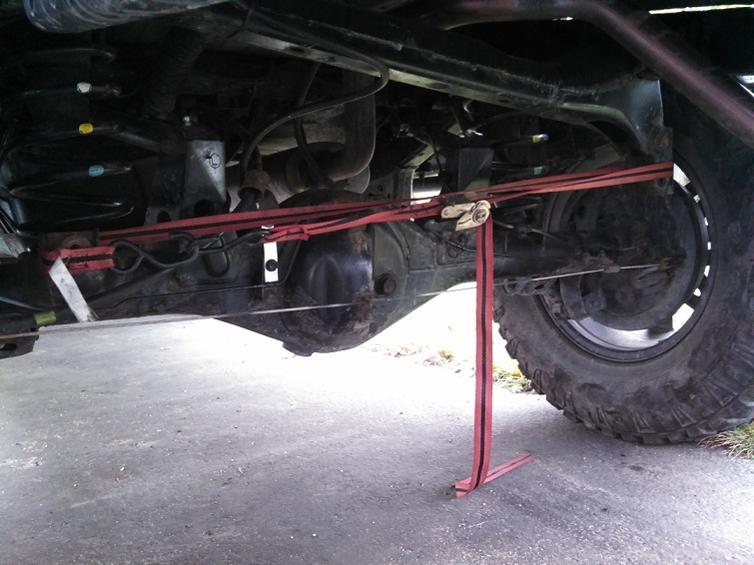

Some Updated Welded shots
My Temporary Panhard Bar

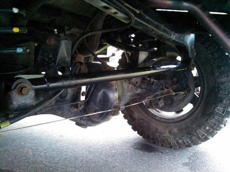

And an Installed Pic.
So far the bar works well, I was able to fully flex the truck and it runs through its full range of motion. Now I can move onto the lower links now that I have some experience on something to learn from.

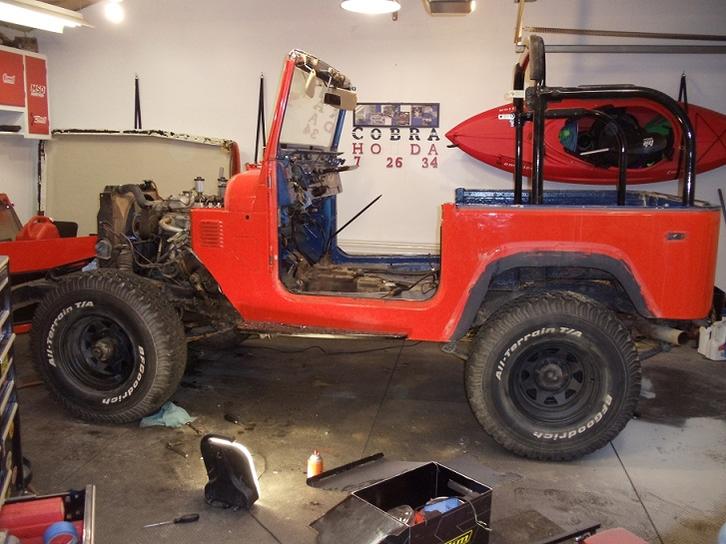

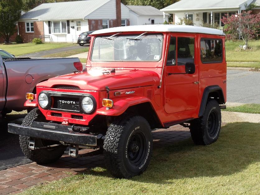

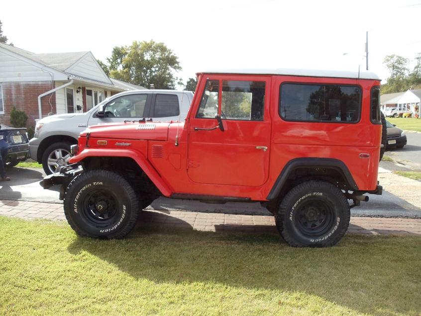

The new addition to the Toyota fleet is here! Picked up this 74 FJ40 in an estate sale. The previous owner was a Toyota enthusatist as well and kept good care of the mechanical functioning of the truck with a 2F engine swap with a 4 speed and Toyota mini truck power steering upgrade. Let the new project begin. :driving:

Thanks guys. Who knows what it will turn into, from a restoration to a wheeler. I have no set plan, just happy to have my dream vehicle. :bravo:

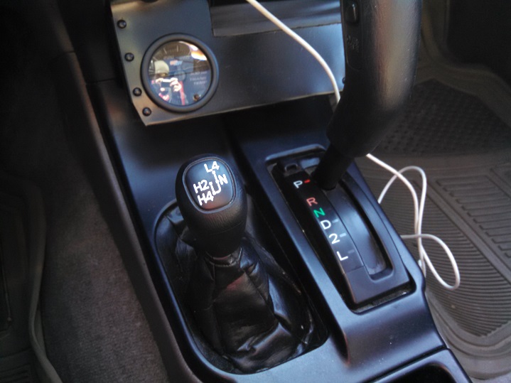

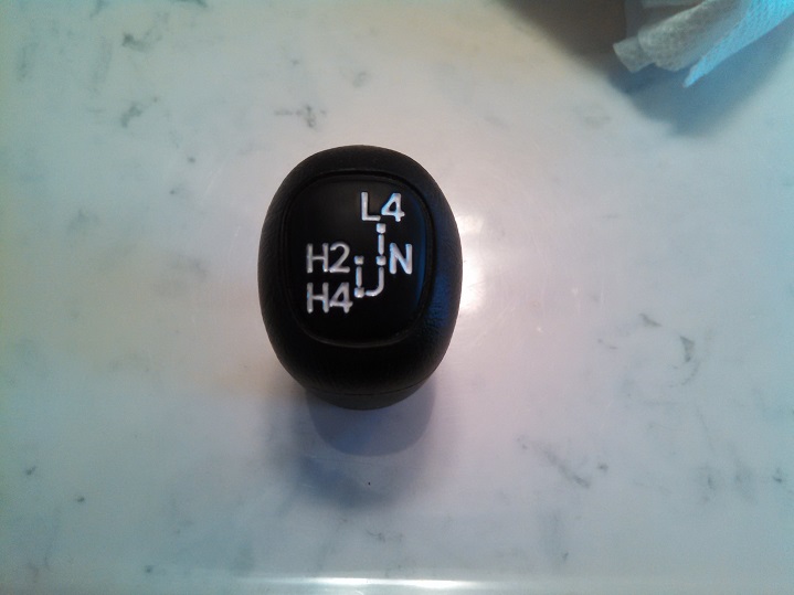

However, I noticed on another thread a forum member did a paint fill on the 4WD shift knob I thought it was a good idea and I gave it a try.
It is just white nail polish. I'm sorry I do not remember who originally posted the idea to give credit to.

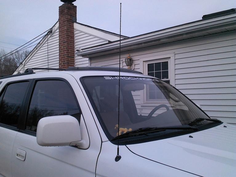

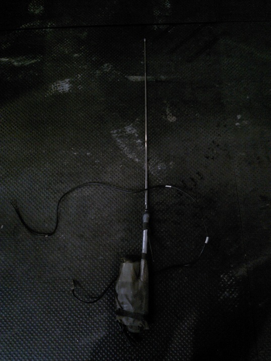

great thanks man. Gonna try this out this weekend. Gotta pull out the head unity anyway to replace the worn speakers.
Yes the thread posted above is the same write-up I used to do this mod. I wouldn't say it is an easy one but certainly not hard either. For me routing the antenna wire was the toughest part, using some thin wire works or a metal coat hanger is nice to fish the wire behind the dash.
One of the better mods I have done. When on the trail just unscrew the antenna and have no chance of it getting hung up!
Any other questions just let me know!

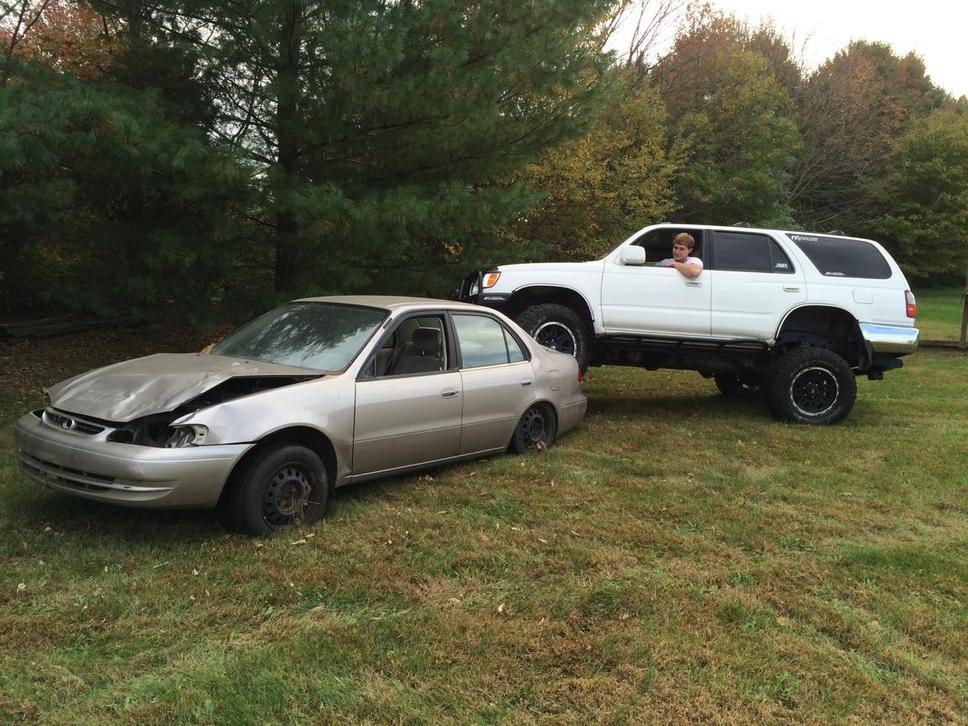

Did some back yard crawling in the Runner today. Corolla was a "totaled" right off after an accident. It was just a quick time to play on it after work, with some more time soon, we'll see what kind of corolla crawling the truck is capable of...
