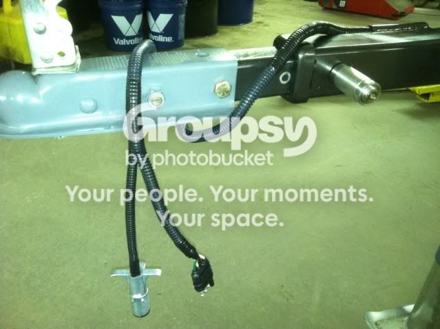

Thank you sir! Your right, I didn't really get into the 12 volt charging system off the truck and to the trailer. To start out I have two trailer plugs, one is a standard 4way flat for the lights, the other is the aux plug that has the reverse light, rock lights, and battery charge wire. I did this because I have 7 circuits and no trailer brakes, if I needed to pull the trailer with another vehicle that had a trailer brake system, I did not want it sending voltage to something other than brakes (lights, etc).
Now for the battery charge wire. (For reference, both my batteries are Die Hard Platinum's, and I don't discharge the trailer battery much below the trucks battery level)

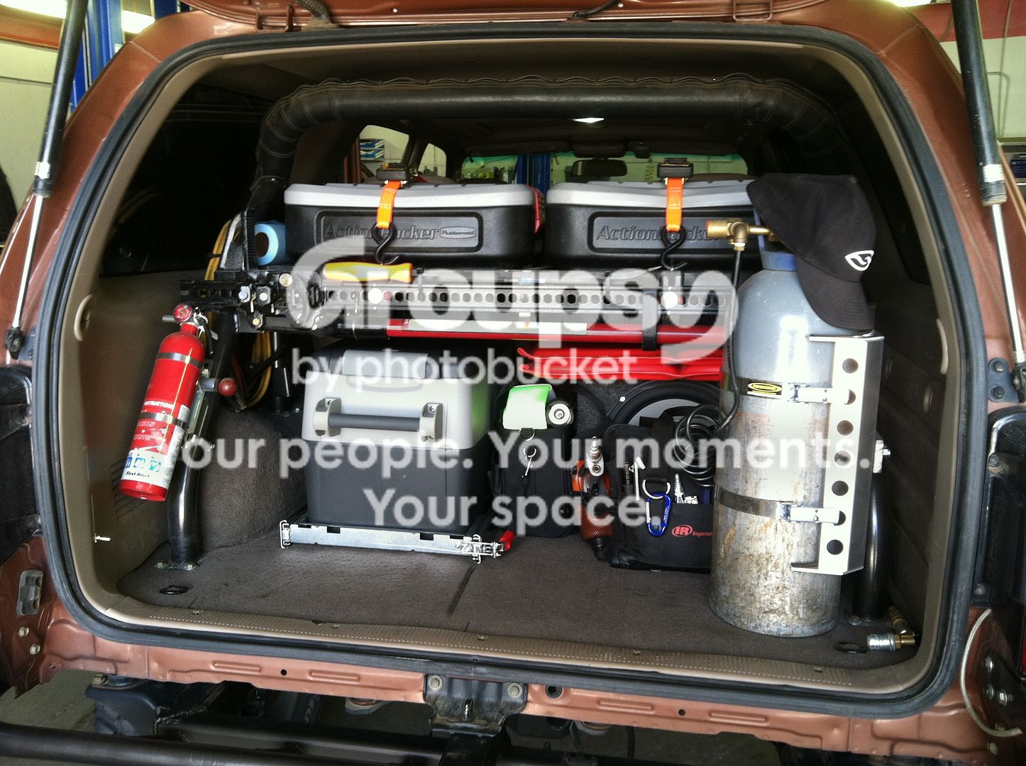

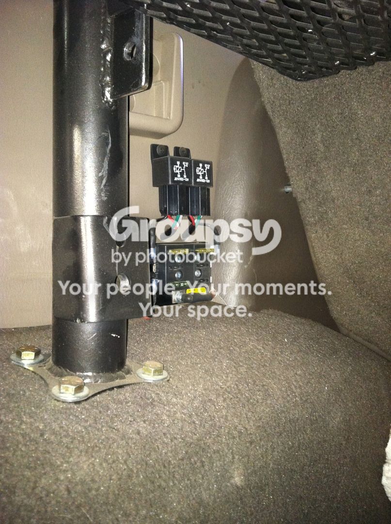

I have a 4 gauge wire going from the trucks battery to under driver seat where my amp is mounted, from there it goes to a distribution block where an 8 gauge wire goes to the amp and another goes to the rear cargo area where I have an aux fuse block.
From the fuse block I ran a 12 gauge (I think) wire to a HD switch in the cargo area. (Just below and to the left of the fire ext. in this picture). From there the wire runs through the plug and directly to the trailer battery.
