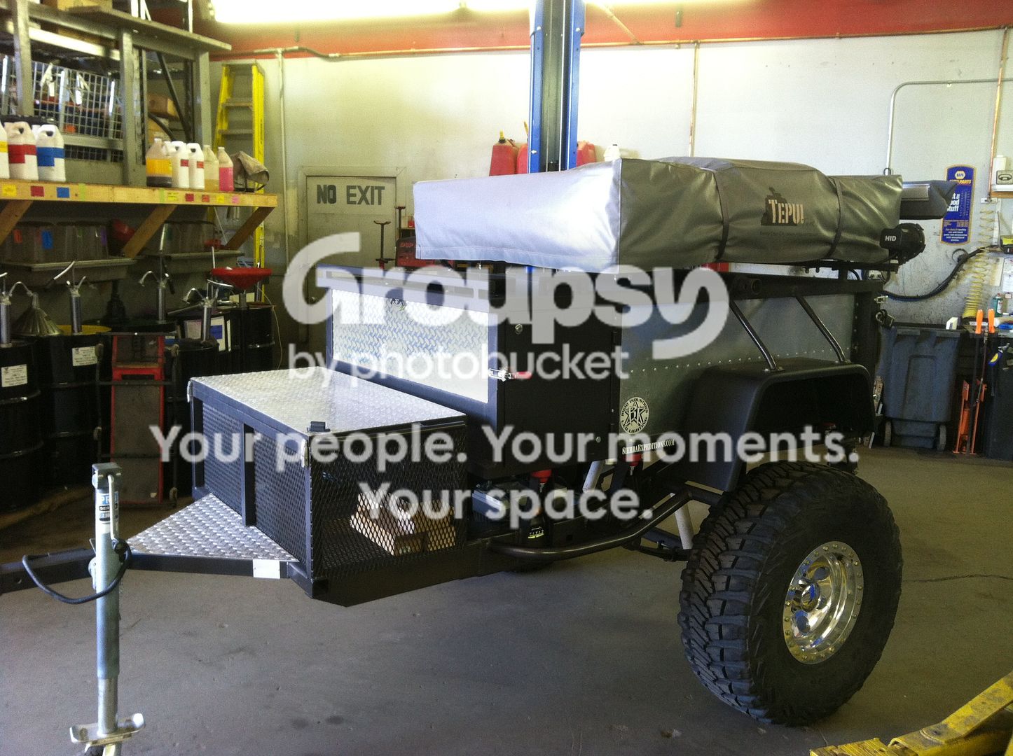

Dirtco’s Camping Trailer - Version 1.2

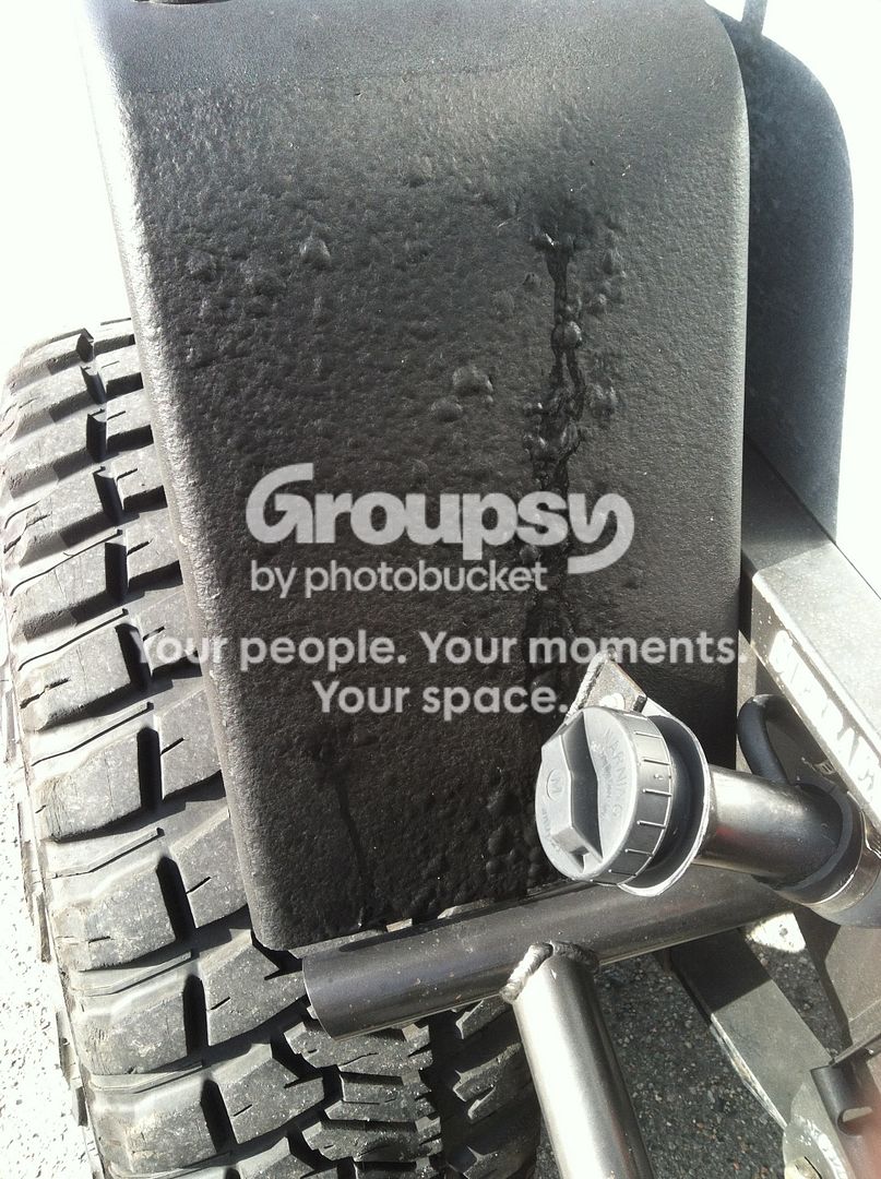

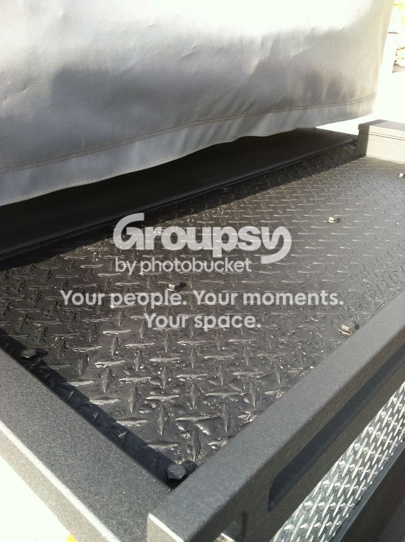

It looks like I possibly got a bad batch of bedliner. I stepped out of my box a little and used the Dupli-Color Bed Armor, it's in the black can.
It rained a couple days after I installed it and the bedliner started to bubble, some how the water soaked into the bedliner and made the bubbles.
So I went over the parts again with Dupli-Color bedliner in the Blue can, the stuff I have used on most of the trailer. It seems to have done the trick, and sealed it back up.

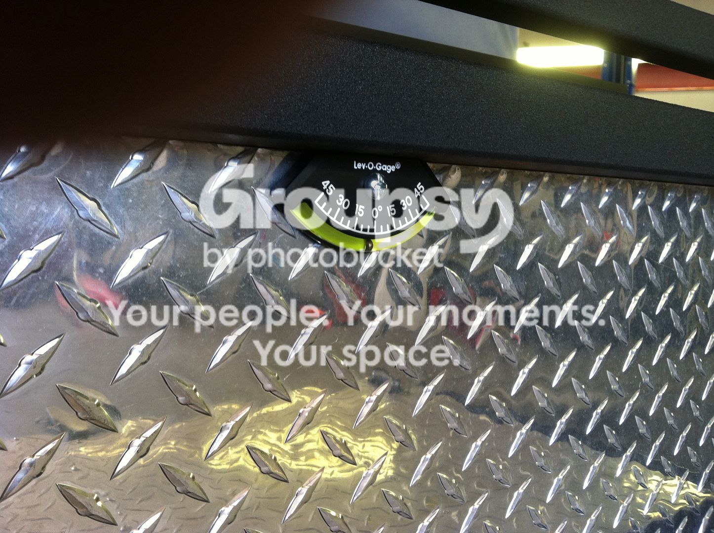

I started by installing some levels, in the past I just did it by eye but this should be faster and more accurate.

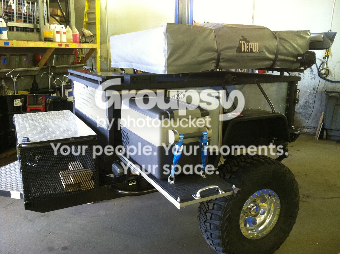

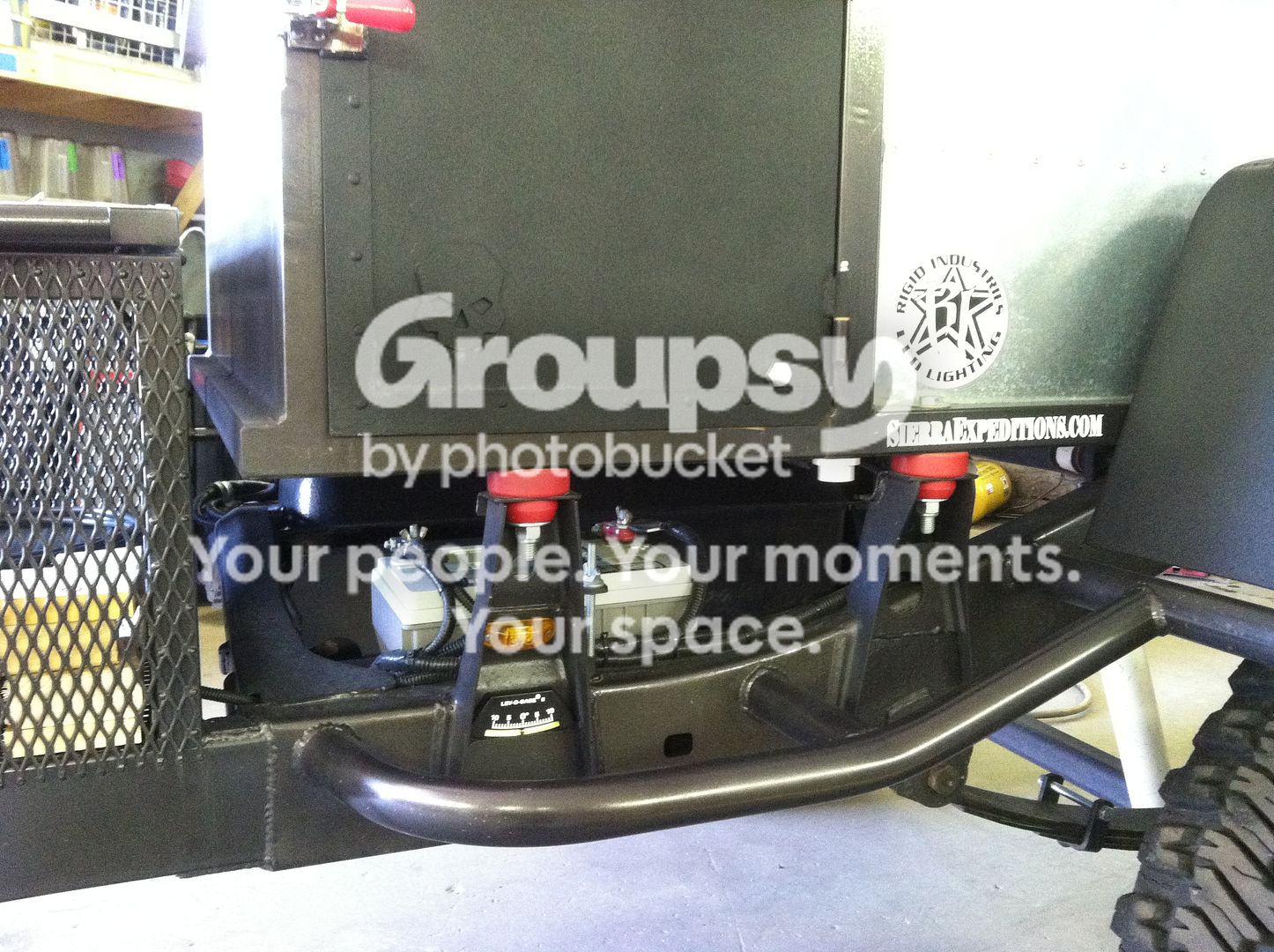

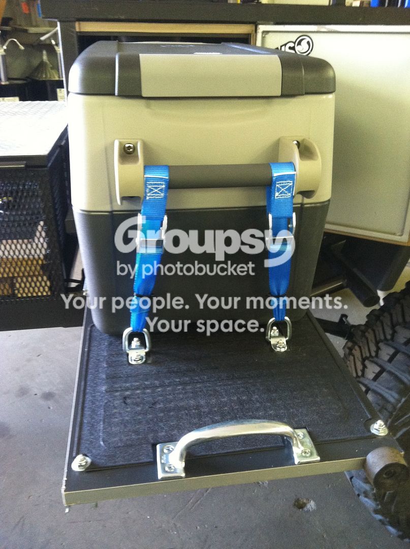

I installed a rubber bumper on the fridge slide out last season to keep it from crashing into the door; it was a last minute addition before a trip. It worked better than I thought it would, but it still had an inch or so to move around and I didn’t want the fridge sliding back & forth while driving around. So I added a small extension to put pressure on the “bumper” and hold the fridge in place. There’s no latch to deal with; open the door and slide out the fridge, close the door and everything is secure.
Now for the good stuff…

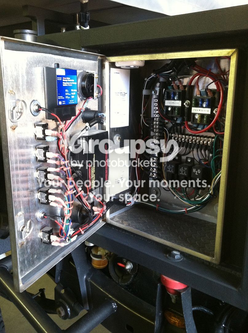

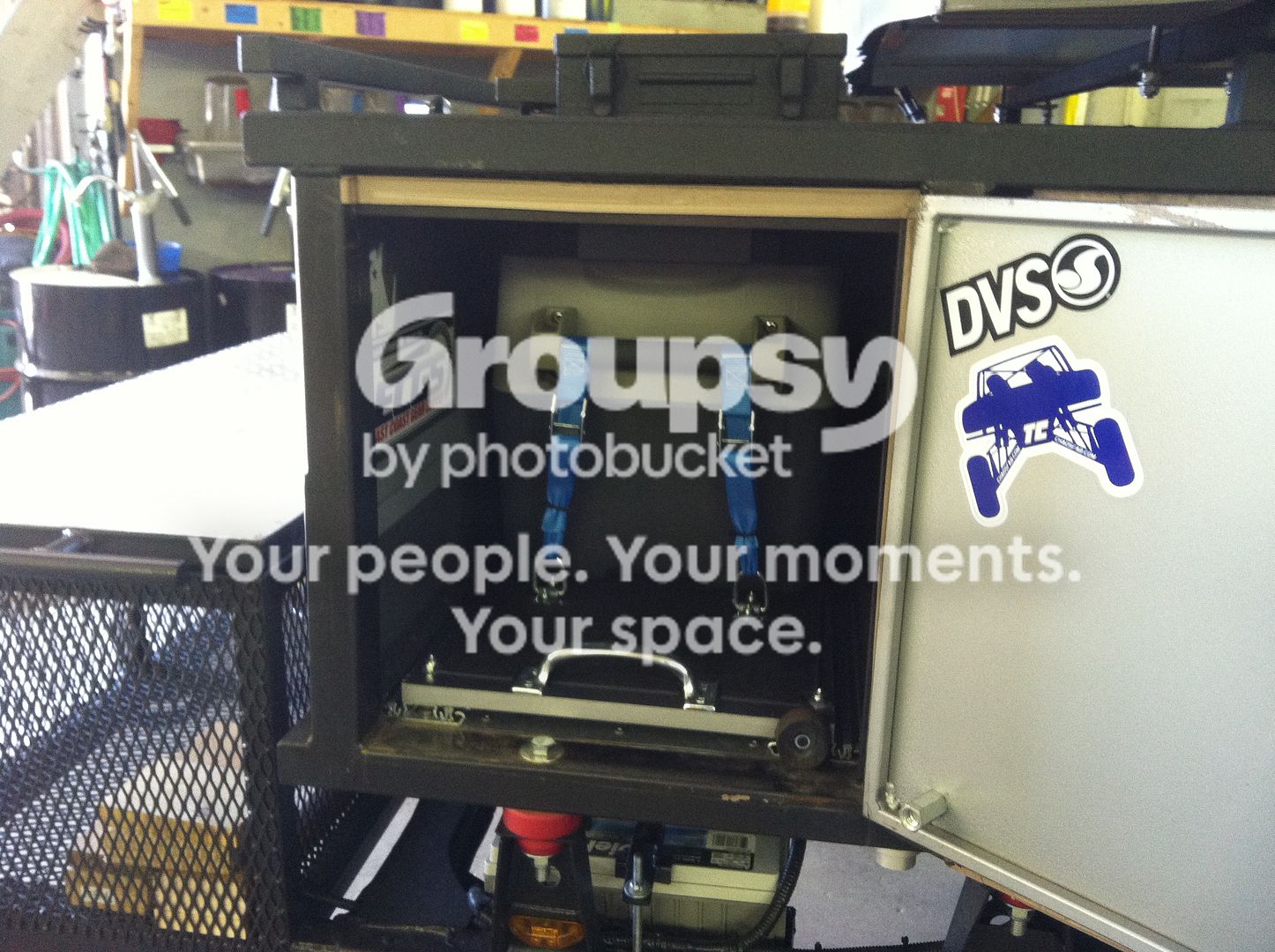

I got the fridge hold downs installed, along with hard wiring the fridge power cord.

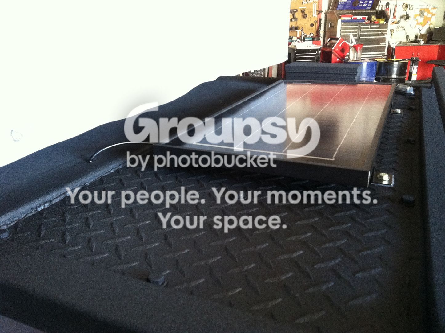

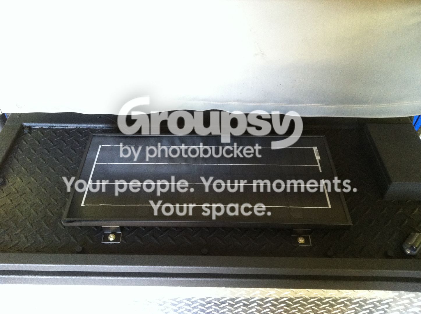

I also got the solar panel installed!
The newly added crossbar should do a good job of protecting the solar panel.

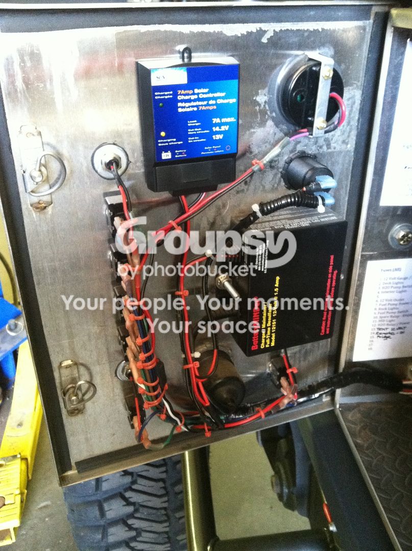

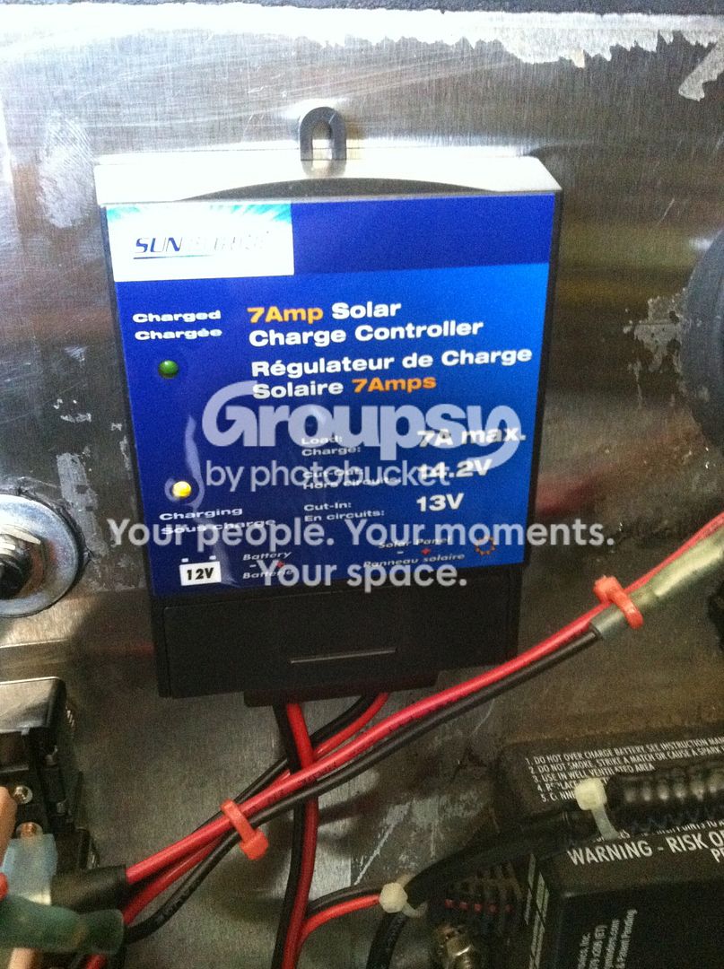

And the solar controller to prevent overcharging the battery.
Thank you sir! Your right, I didn't really get into the 12 volt charging system off the truck and to the trailer. To start out I have two trailer plugs, one is a standard 4way flat for the lights, the other is the aux plug that has the reverse light, rock lights, and battery charge wire. I did this because I have 7 circuits and no trailer brakes, if I needed to pull the trailer with another vehicle that had a trailer brake system, I did not want it sending voltage to something other than brakes (lights, etc).
Now for the battery charge wire. (For reference, both my batteries are Die Hard Platinum's, and I don't discharge the trailer battery much below the trucks battery level)
I also looked into the link you have for the Toad-Charge, but after doing some research I felt it wasn't really required for my application. Read this thread: Trailer - Light Charging Wire - Expedition Portal
I have a 4 gauge wire going from the trucks battery to under driver seat where my amp is mounted, from there it goes to a distribution block where an 8 gauge wire goes to the amp and another goes to the rear cargo area where I have an aux fuse block.
From the fuse block I ran a 12 gauge (I think) wire to a HD switch in the cargo area. (Just below and to the left of the fire ext. in this picture). From there the wire runs through the plug and directly to the trailer battery.
Thanks for the response. I see you've now added a solar panel, which runs you up to three potential charging sources for your battery: 12V from the alternator, 12V from the solar, and 110V from your shore power. Is that correct?
How do you have all of them wired? I saw you had the solar leads going to its own charge controller, and I'm assuming based on the post you linked me to that the 12V alternator lead is manually controlled and routed directly to the battery, but what about the shore power? Is that a manual switch as well, and what charge controller do you use for that?
Yes, that is correct.
Each one of those choices has it's time and place; 12v from the truck when I'm driving around, 12v from the solar to keep up with the fridge while it's setting at camp, and the 110 shore power (during storage, before/after trips, and when hook ups are available).
I went over the 12v from the truck (straight from truck with on/off switch. The solar charger goes through the controller (to keep the battery from getting over charged), and directly to the battery. It should do a good job of keeping the battery up when parked, and extend the time the trailer can set at camp without being hooked up to the truck. For the 110 I'm using a marine shore plug that goes to a batteryminder trickle charger, then directly to the battery.
And just to make things even more complicated, I have a fourth option! I installed a standard 12v plug in the back of the trailer, and the 4Runner has one in the back cargo area too. I have a 12v to 12v extension cord that allows me to plug the trailer into the 4Runner when it's parked next to it. This lets me be staged at camp the way I like (4Runner backed up next to the trailer, both tailgates open) and still charge the battery while I'm packing, unpacking, cooking, etc, etc.

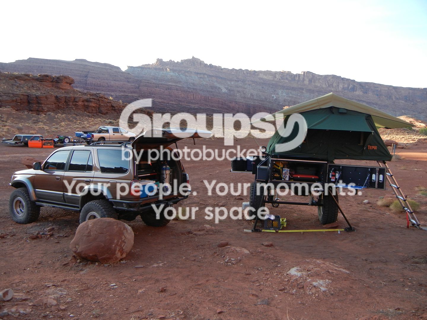

And that's how I camp in the background with all my crap over my trailer and truckbed, hahaha! Man, that was a fun Moab trip!
