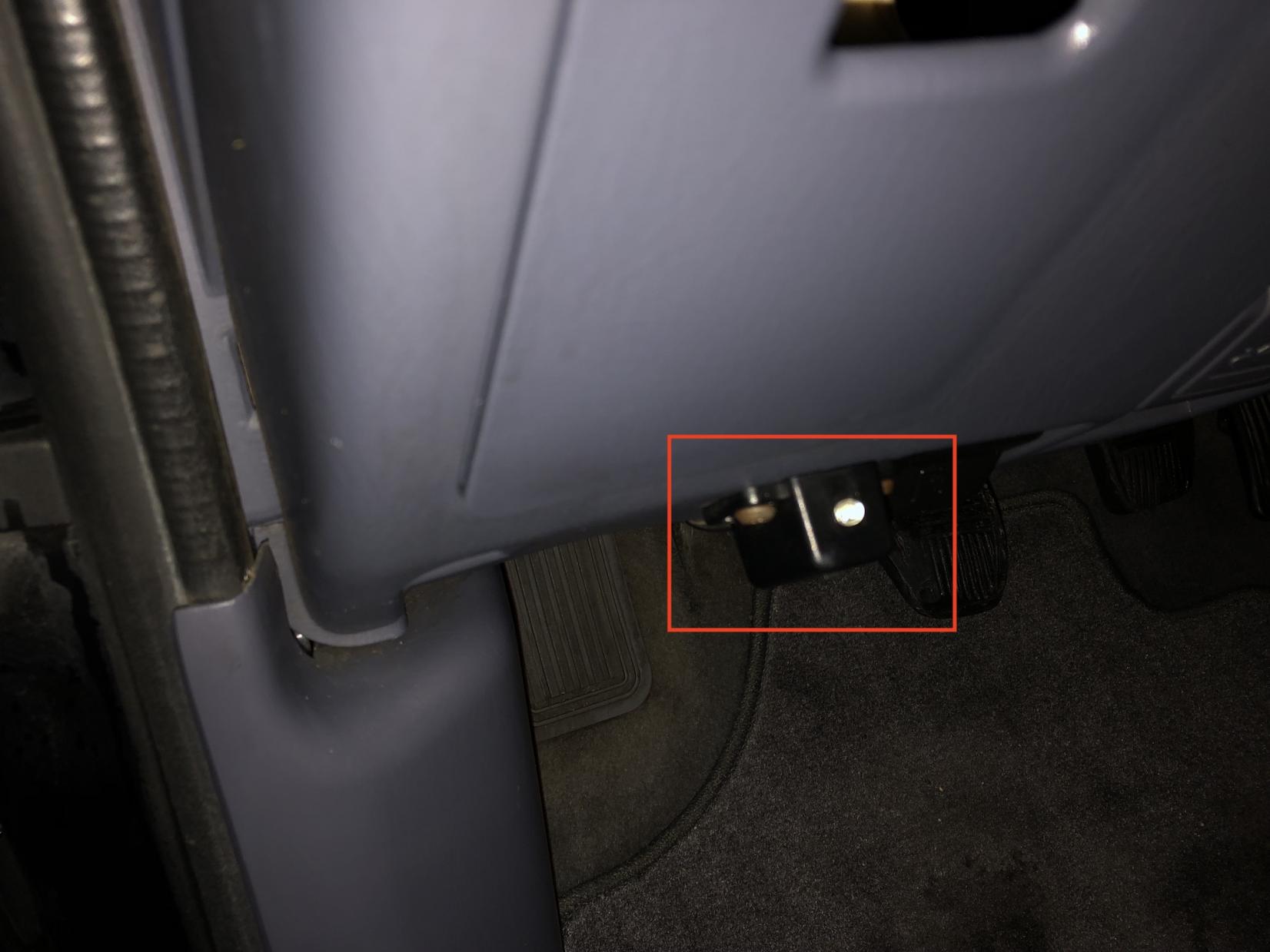

But I wasn't able to get to the programming mode. Is this a factory alarm (it blinks with a blue light):
It has a button in the back of the led. Does anyone know what that button is for?
Also, I was able to program a 2nd remote using the instructions used for a factory alarm. Does that verify that I do have a factory alarm?
^ that does not look factory. Almost looks like a base control for a amp. Either way it’s not factory. And never seen a alarm use that.
OP I’m not sure how to disable or how to remove the factory alarm. The brains are under the seat. If you were to unplug the brains. The truck won’t start. So I’m not sure man. Have to dig into the harness.
