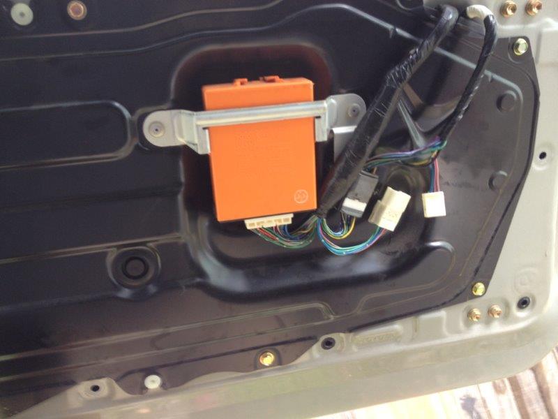

Well, i went ahead and removed the plastic tailgate panel to expose the wiring. The smallest wire plug (1 large blue and 2 smaller wires) I unplugged and it disabled the motor completely. I guess I got it right the first time cuz that solved the problem. I just need to plug that in whenever I want to roll the window down - which is only a couple times a year. Only inconvenience is having the plastic panel removed. I might cut a hole a hole or something. It's only once screw to remove the panel, though.
My vehicle happens to be one that requires both the ECU and the keyfobs to be replaced to fix this problem, so total cost would be upwards of $500 CAD I'm sure. I'm happy with my fix. :)
Anyhoo. Problem solved.

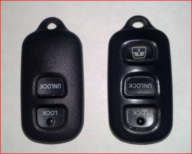

Simple fix to rear window roll down problem.
Like many others, I have been dealing with the problem of my 2000 4Runner Limited's remote opening my rear window unexpectedly at the worst possible times while in my pocket, even with the window 'lock' on. Finally got tired of mopping out gallons of rain water from the cargo area, gave up and took my remote off my ignition key where it's sat in a drawer for the past twelve years. I found this remote shell on Amazon for $6, just have to take the guts out of your old remote and put them in this one that has no rear window button on it, works perfectly! As simple as replacing your remotes battery.
www.amazon.com/gp/product/B00KTHY2DA/ref=oh_aui_detailpage_o00_s00?ie=UTF8&psc=1
