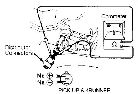

Change cap and rotor, probably wires too. Test the distributor according to the manual, not sure if this is 4 or 6 cylinder, here's what you would be checking for resistance if its the 4 cylinder:
Manuals are all over this site, find and download the one for your 4 runner then find the test for the distributor to see what the resistance should be. I'd also check it hot and cold to see if its different.
