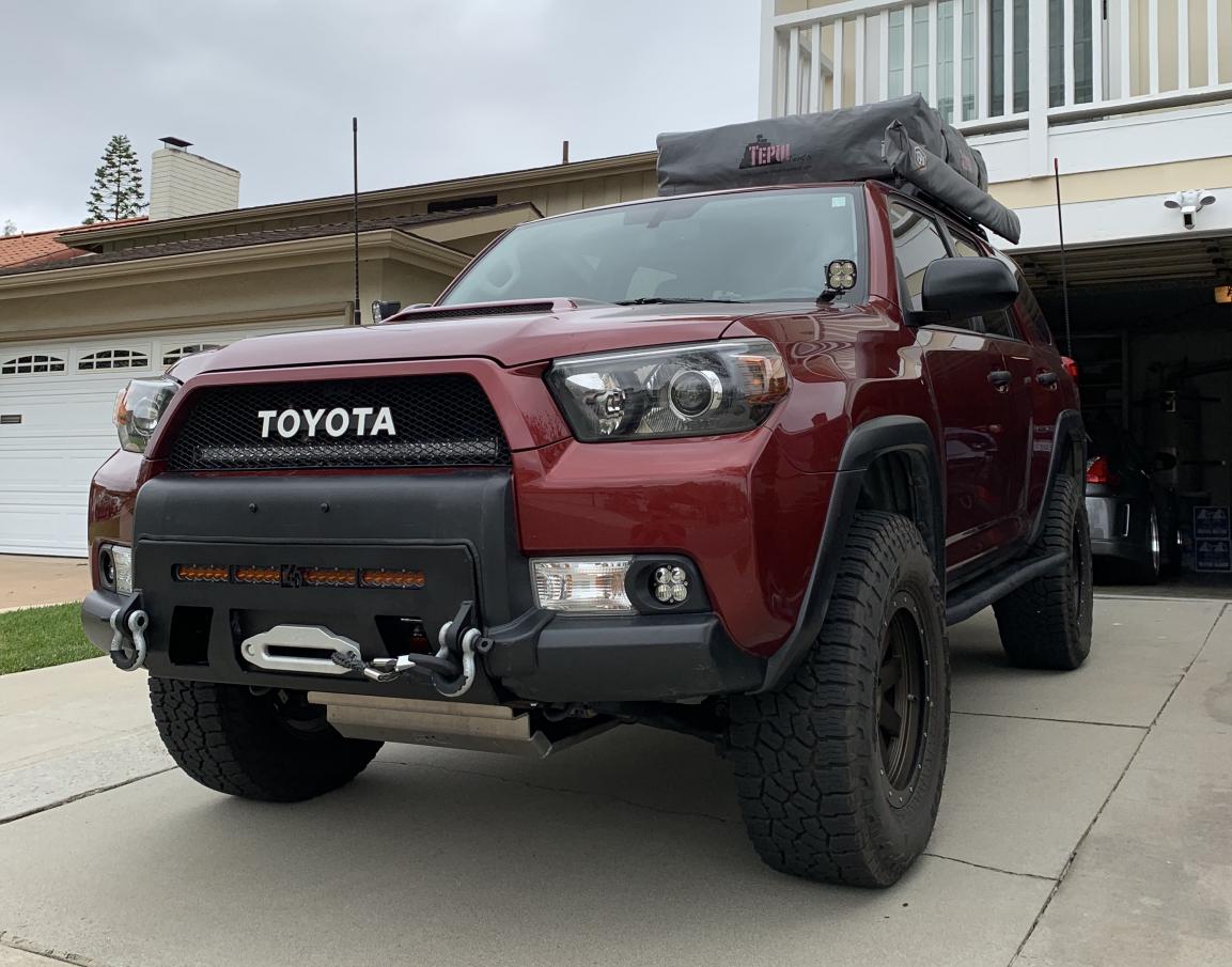

Got them and like them.
I went with spot because I wanted to avoid glare off the hood. But with my other lights I have them pointed out enough that a combo or flood would be nicer.
No problems with durability and damage. As long as you go with a quality light there should be no issue. Most cheaper lights are good in regard to brightness, but run the long term risk of moisture in the lens and faster fading/chipping.
Not the best photo

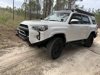

I have never had an issue with Rago but I've also heard nothing but positive reviews with Caliraised. I have Rago's low profile with Baja Design Squadron Sports (Wide angle lens) and they are plenty bright. I was leaning towards S2 to be less intrusive but the squadrons are not noticeable anymore. Mine also sit out in the Cali sun all day and the aluminum faces on the Bajas are starting to fade a bit but no issues with moisture or functionality.
Not the best photo, but its the only one I have without running out and taking a new one.

This may sound stupid... but I always forget about the 2010-13 T4R. So when I saw that pic, at first I was like "What is going on with that dude's bumper? And what's the story on those headlights?"

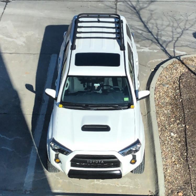

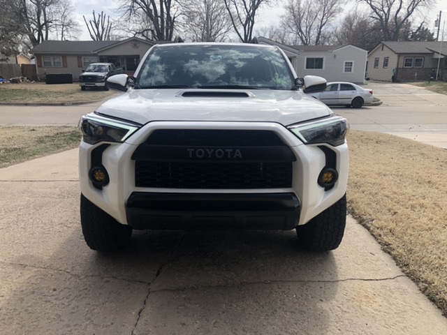

I’m running Rago low pro brackets with Baja squadron pros amber combo. Haven’t had them too long but I’ve had squadron sports as fog for over a year and they are holding up great. I didn’t have to modify the cowling and I got the rock guard covers to protect them.

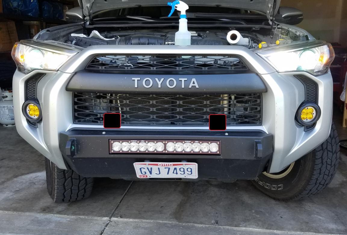

This makes me wonder. If you could mount ditch lights on the bumper, how close would you get to the same result as mounting on the pillar? Obviously with the lower mounting you wouldn't get the same distance. Being mounted inside the grill like pictured would restrict how far perpendicular to the truck you'd get light as well. Would the setup be better with each side aimed outward? Or would it be better aimed crossways, driver's side pointing at passenger ditch and vice versa?

you're really losing the main point of ditch lights if you mount them in front of the wheels like that, in tight turns if there is no ambient light you can't see what your wheel is turning into because it's behind the light. normal driving it's not a big deal because you have spatial awareness and see it as you come up to it, but in technical driving that's not always the case.
that being said, i don't have ditch lights, i just shine a flashlight out the window to see what i need
Thank you. I knew I was missing something important about them being mounted on the pillars!
