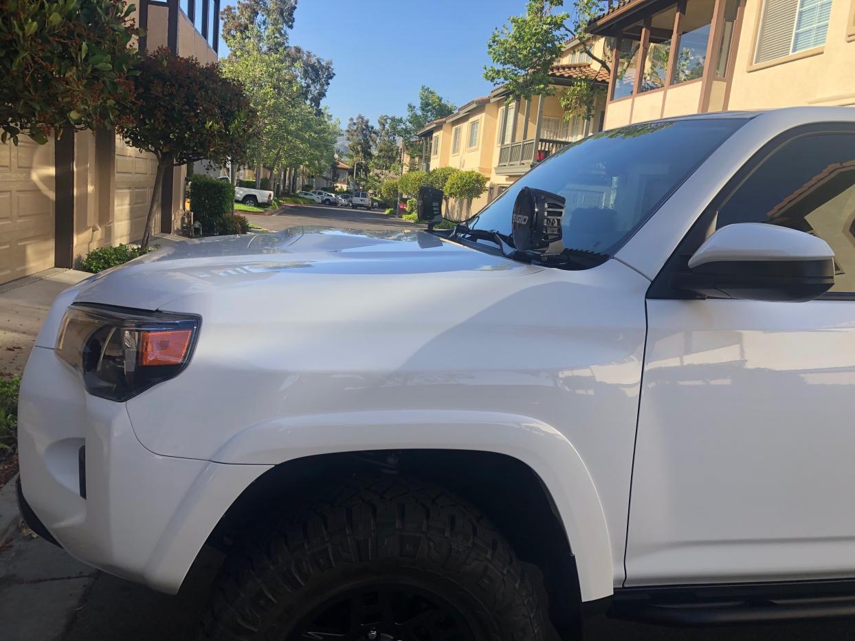

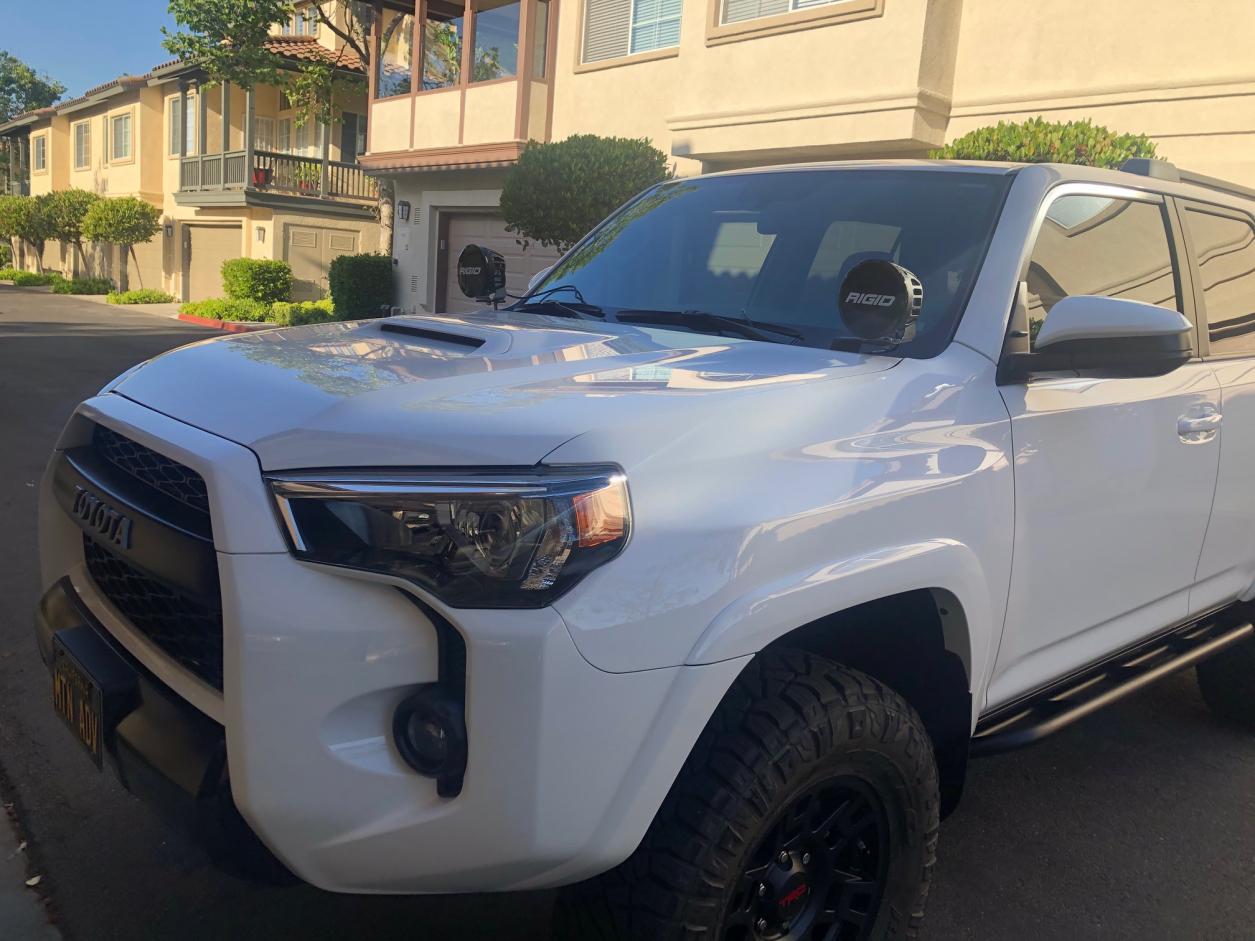

Rigid 360 6 inch lights on SDHQ a pillar mounts.
The mounts are the most heavy duty I've seen and support the light very well.
Wire harness is on backorder from Rigid for another week.
