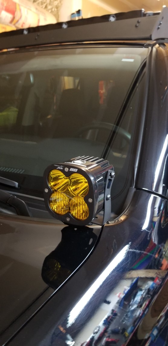

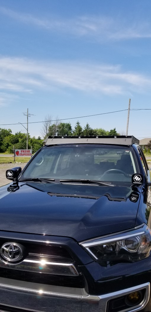

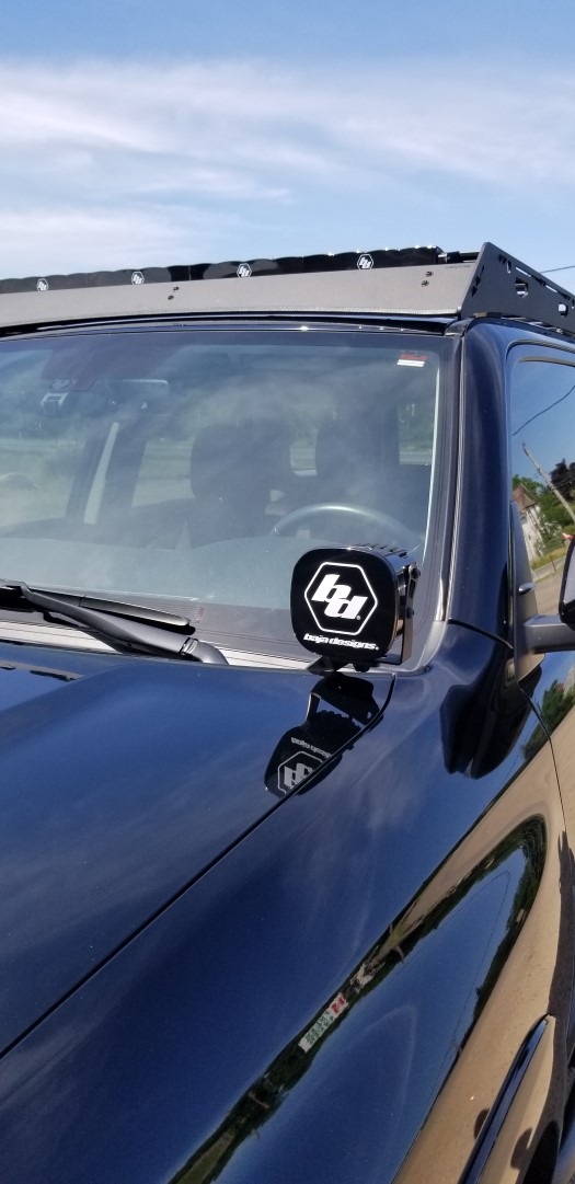

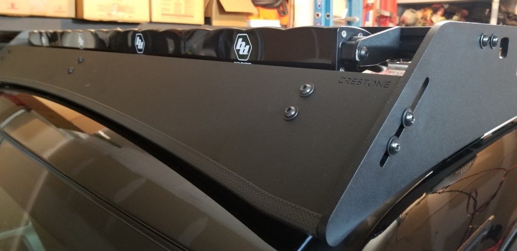

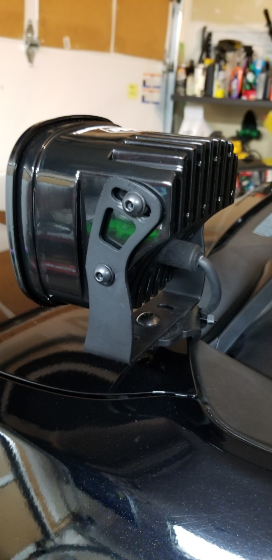

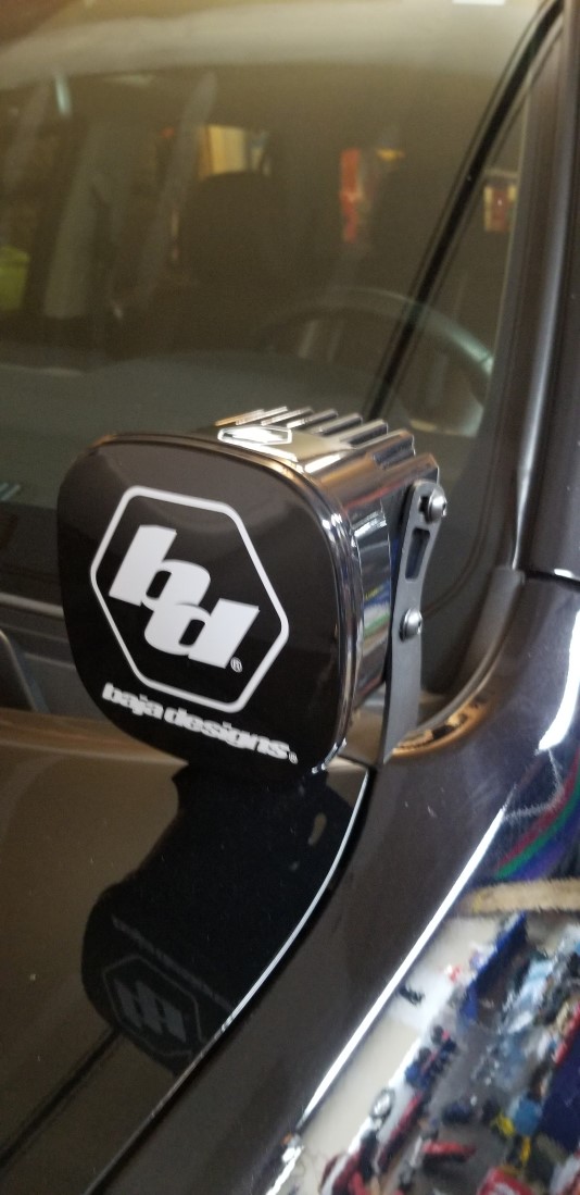

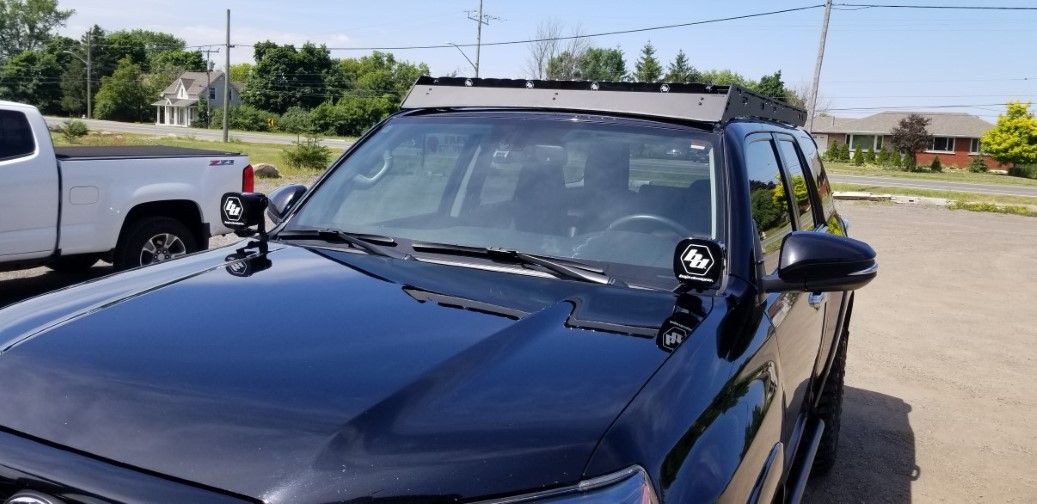

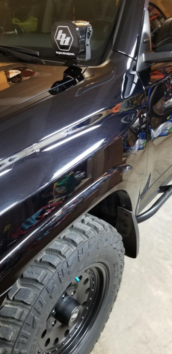

So finally got my ditch lights on. Also put on my new lightbar. Bar is Baja S8, the ditch lights are Baja XL80s. I have an auxgang for install, but not sure if im gonna use it. Anybody recommend a better light terminal box for a quality electric install?
Lights are all amber, I also have Baja amber fogs on it. Skid plates going on this weekend. Lots more to do, but good to get started after waiting for winter to end.. :madgrin:

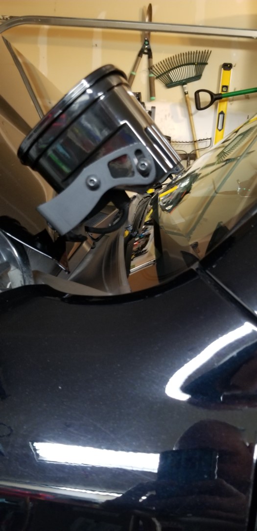

Looks good! How are ditch lights mounted? How do they interact with the hood when you open it?

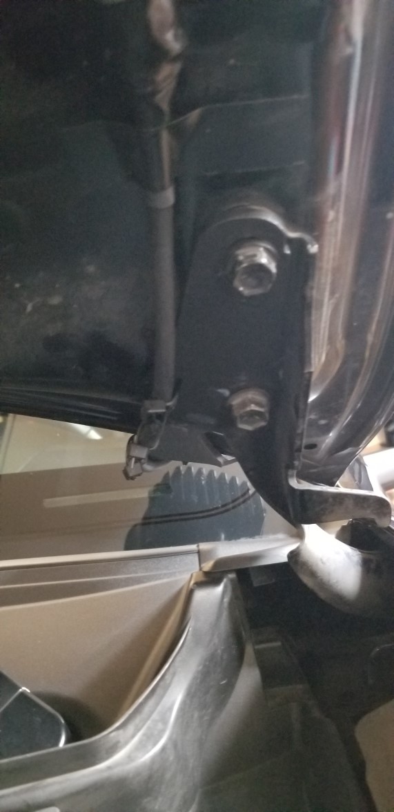

Ditch lights are mounted on RAGO low profile mounts. They are bolted on each side on top of the two hood bolts on each side. There are absolutely zero clearance issues, when you open the hood, plenty of space all round. I have them secured to all the parts using hi security fasteners, either hex-pin type or double pin type, then I have epoxy on the fasteners for extra. The nut retaining the XL80 mount is a specialty spline drive 3 spline nut for extra security. I painted all the stuff black to blend in. Some minor touch up still needed. :drummer:
Edit i went out and took some pics for you on fasteners and clearance.

Have you tested the lights out yet? I am curious whether the roof light bar actually helps and if it causes glare or not. I bought the optional front cutous plate for a 40" light bar for my SSO rack and debating if I should put a light bar up there or not.
The ditch lights also look good. I have considered upgrading but haven't found the need for it yet. I have S2 Pro ditch lights and they seem to be sufficient for now.

No havent powered them yet.They are recessed abit back and the front fairing of the rack may reduce hood glare.
