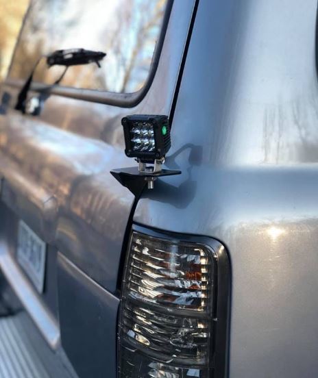

There's another thread on rear facing lights for closing farm gates. I could use some. Digging around google images I found this homemade rear bracket.
Chatted with him a bit on facebook - says there are just too many bends required (4) to get it to work with the 4runner and make it so the hatch doesn't rub.
Is that with any gen runner? Seems like a lot of the products aren't available for runners. Id be super interested in the rear window panel with molle brackets attached.
