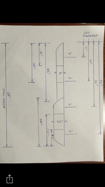

Here you go... the thing to remember is they til up slightly. Be careful to measure against the bottom of the door, so it doesn't hit the slider when opening. My bender dies are 6" on center. Good luck with your sliders.
IMG_3706a_zpspwl5egxq.jpg~original
Thank you so much for sharing this. I'll be using it as the basis for mine. Can't tell you how much easier this makes the planning. :cheer2:
Thanks for sharing! Definitely going to do my own version soon. Great DIY thread.
awesome design, i'll have to toy around with it a little and build myself a set! are all the measurements from the tube outsides to tube outsides or centerline to centerlines in the drawing?
