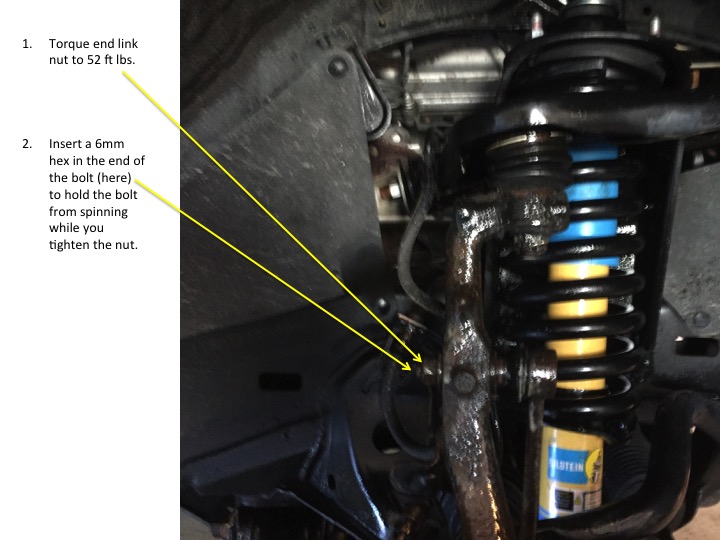

You do not need to remove sway bar endlink or sway bar to remove the strut and I would not remove the lower shock bolt until the spring has decompressed!
Ok, to remove it I will agree. However when you go to put the new setup back in, you're going to be removing the sway bar. I'm guilty of trying to do this without removing the sway bar. I learned my lesson upon the installation part.
*This is a great thread by the way! Wish I saw it about a month ago LOL
I couldn't get mine out without taking the swaybar bushings out and moving the bar.
I've replaced the front struts on a GX470, 08 Tacoma and two 4th gen 4runners this past year and have never had to touch the sway bar! Are you not loosening the alignments bolts on the LCA?

As other have noted, I wasn't able to get the lower control arm to drop far enough without loosening the alignment/bushing bolts. One small add for anyone replacing stock equipment. The strut top nut is 17mm and you'll need a 7mm open wrench to hold the shaft. If you're installing 5100, the included top nut is 19mm.

Great thread. I changed my struts and rear shocks this week, thought I would add my two cents. I used the KYB shocks and complete strut units. Struts were pretty easy, I only dropped the sway bar, didn't remove end links. Had no problem removing or replacing the struts. Long bar to press LCA down, pretty tough. Also, that inside nut on the top of the strut, if you bend the wheel well in a little, a socket and ratchet works great.
