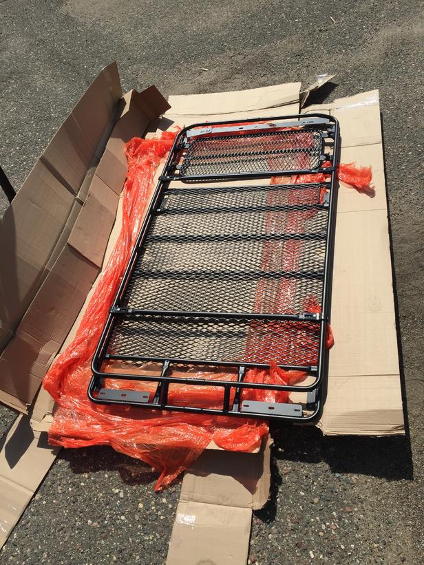

2.) Upon receipt of the rack, I discovered that it was a pretty heavy package combined with the wooden crate bottom, padding/packaging material, etc. After about 15 min of unpacking, I was able to get started.
Everything provided is separated nice and neatly into labeled heavy duty zip lock bags. The directions provided are detailed and heavy with diagrams. I think they did a great job explaining everything step by step. I think my only disappointment was the top plate that hooks onto the top of the rear gate to hold the ladder (see picture/ladder description further below for reason). Not a huge deal but other than that, the craftsmanship and supplies/directions provided were fantastic and over the top. After going to a recent Toyota ralley and seeing so many different roof racks in one spot, the Gobi (IMO) was no comparison. Clean, sleak, low-profile, well built.

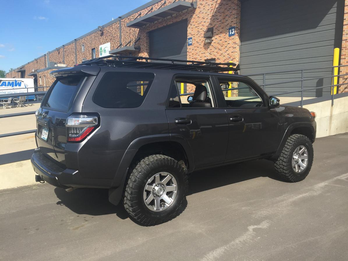

Hope this thread helps some of you to some degree. Overall it was pretty straight forward. Gobi's instructions say to snug everything until its all lined up...then tighten down...but I never really had to line anything up. It fit perfectly from the get go. Overall I'm highly satisfied and have had quite a few comments from random people about it.

It looks like you got the Ranger Roof Rack, not the Stealth. Trail Duty says the Stealth is flat on top from front to back while the Ranger has a 2" rise from the top surface of the rack. In any of the photos on line I've yet to see any difference between the two. Some sites show the same photo for both racks. From their description:
"Front light bar supports up to 4 off road lights, available in Stealth or Ranger versions. Stealth version provides a flat surface structure front to rear along roof rack’s highest surface level. (Great for canoes, boats, bikes, skies and large cargo carriers.) Ranger version provides the option for larger off road lights and rises 2” higher than the roof rack’s highest level surface. (Great for canoes, boats, bikes, skies and mid size to small cargo carriers.)"

"The Gobi Toyota 4Runner Stealth roof rack adds 8" of height to vehicle."
Does it really add 8" of height above the original OEM roof rack? It doesn't look like it's 8" taller.

In your photo it looks like where you said the ladder plate was off by 1/8 to 1/4" you could have just moved the plate back to fit the contour of the roof and still clear the hatch door. What do you think?
[MENTION=115572]DesertCanyons[/MENTION] , what you see in this thread IS the STEALTH.
It is 8" off the truck's roof, NOT above the OEM roof rack. You remove the OEM roof rack to install the Gobi racks.
From last month's group buy, the STEALTH is vastly popular due to the fact that it still allow your 4Runner to fit into "typical" residential 7ft garages. And RANGER most likely won't.

I def have the Stealth rack. I wanted low profile. See [MENTION=119516]jicko[/MENTION] above.
I moved the top ladder playe around in every possible way and couldnt quite get it to line up with the contour of the roof. Its only off by 1/4" so no big deal to me....but it was off. In order to get it to match the contour, the curved/hooked portion would not be seated completely against the top front edge of the lift gate.
