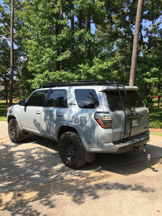

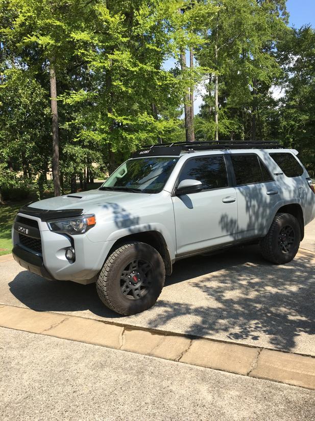

Great post, very helpful. Used it to install my stealth rack and ladder on my 2017 TRD Pro. Studied your steps and photos before the rack arrived and things went smoothly. Some of the parts have changed a little since your original post - the front feet no longer have adhesive pads and the undersurface of the wind deflector is padded now. Used 3m paint protection film under the wind deflector and I think it will protect the paint. Used the marine silicone and thread compound for waterproofing as you suggested. Well worth the extra time. All in all it took about 3.5 hours to install.
