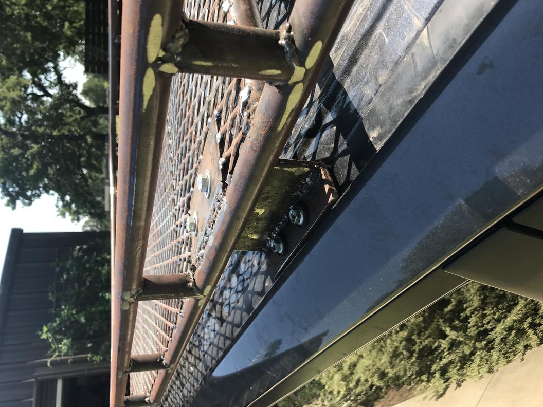

Awesome work!!! how was the tube welf together at the joint? Can I see a pic at that joint? and how long was the tube? 20 feet? one tube for each top and bottom piece?
Sorry just getting to this. I used a pipe notching tool to round the end of each piece to be jointed. It certainly made the welding easier. Below is a picture of a couple of the joints. Please don't judge, as this was my first time wire welding in several years, and my welds are ugly, but they got the job done. I borrowed the welder, and so I didn't have the luxury of a lot of practice.
For the top and bottom tube frames, I ended up having to weld in a 3 foot section in the rear, as my 20 foot sections wouldn't quite cover the length needed.

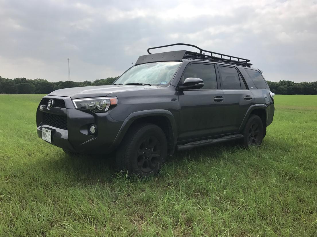

After months of wanting a Gobi Stealth Rack for my 5th gen, but without the cash for one, I finally pulled the trigger...and built one.

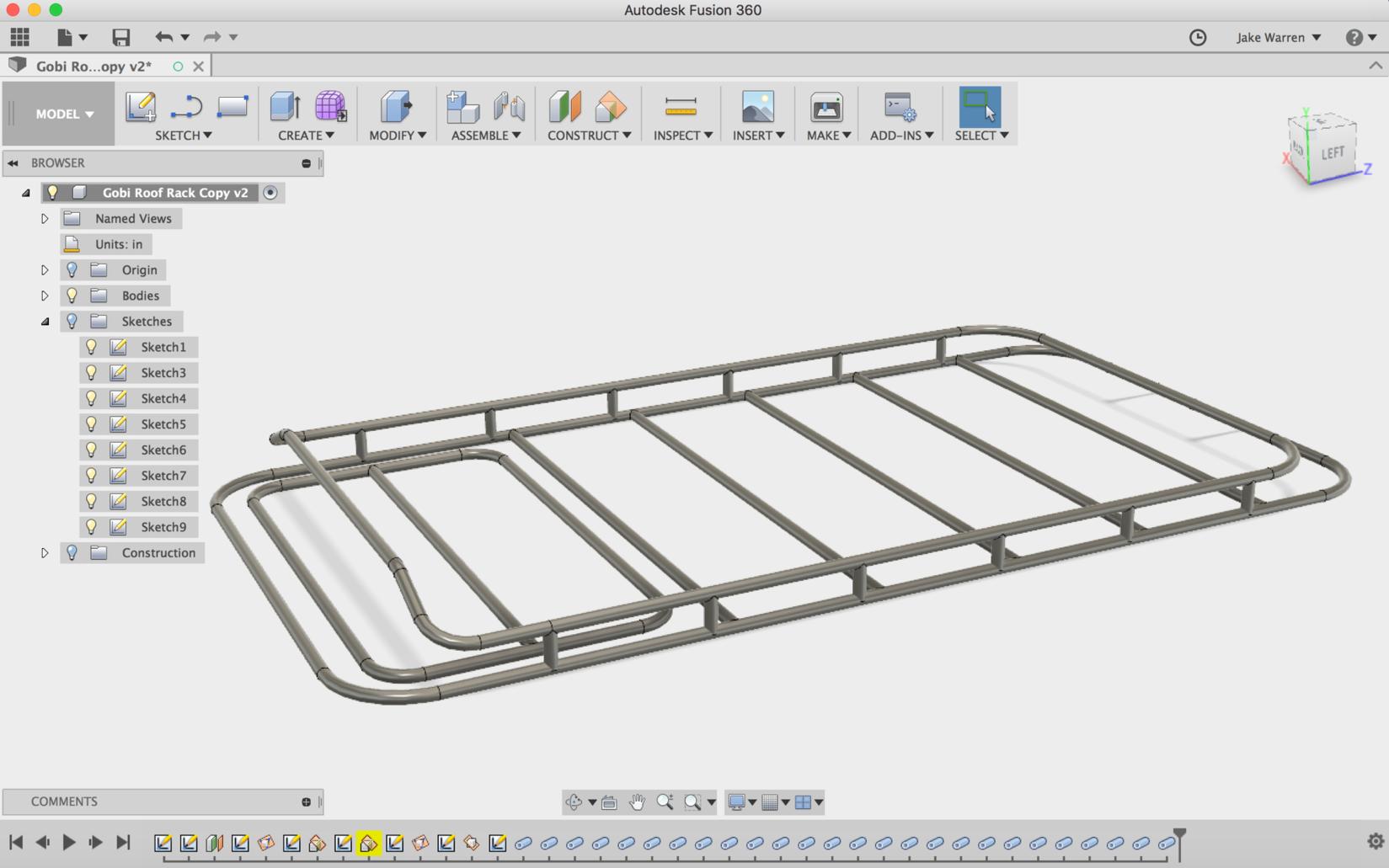

Gobi is kind enough to provide specs on the material their rack is made of on the product page (16 gauge, 1 inch steel tubing) and the length, width, and height. This gave me a good starting point.

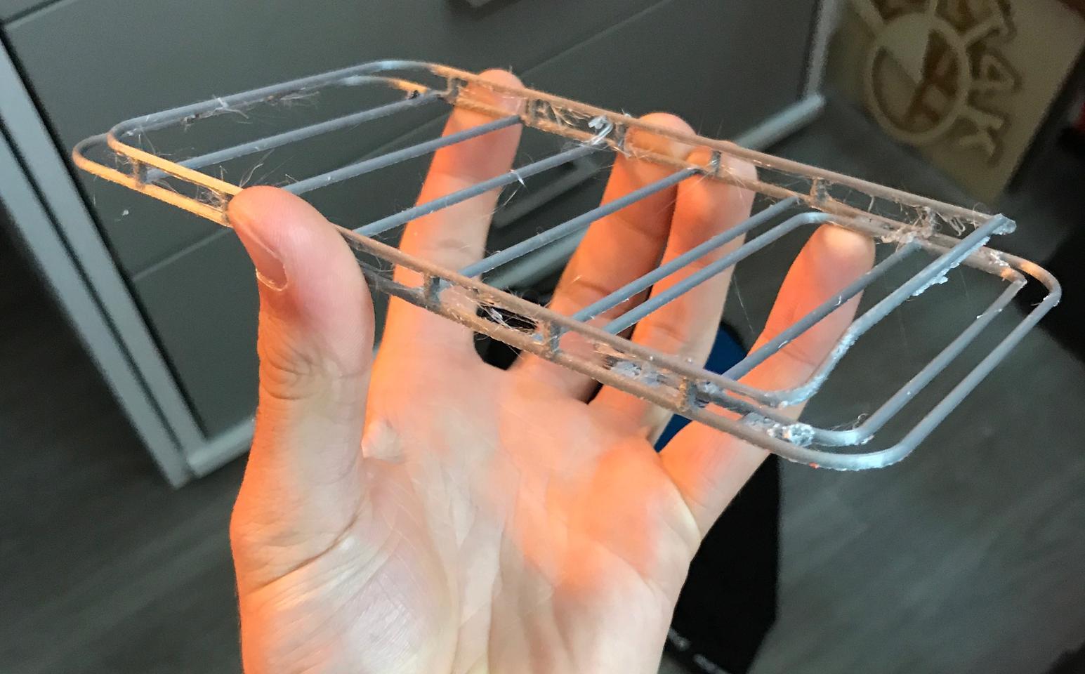

I drew it up in Fusion 360 just for kicks, and 3D printed a little model to get a look at it.

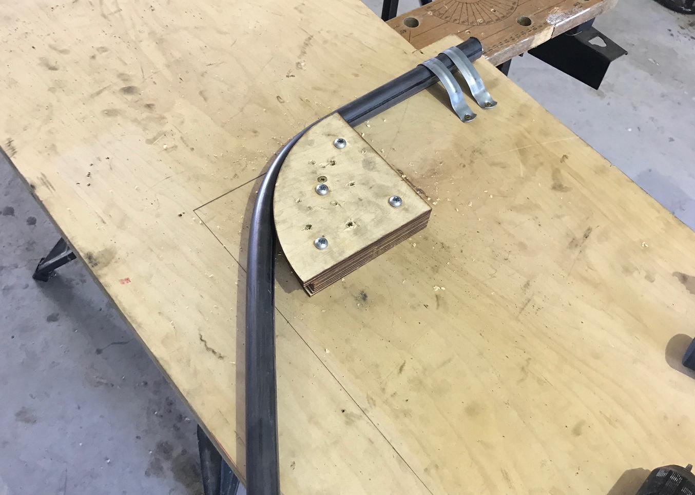

As for tools, I decided to pick up a pipe notcher from harbor freight ($50). Rather than buy an expensive bending tool, I made my own wooden bending jigs ($10), and they ended up working just as planned. These were mounted on a sheet of plywood and moved around, and I hand bent each piece around them. It gave me a good result for the simplicity, with very little flattening and no kinking issues.View attachment 257028

Planning on a coat of primer, followed by some some spray-on black truck bed liner.
Until that's done, lots of pictures!
