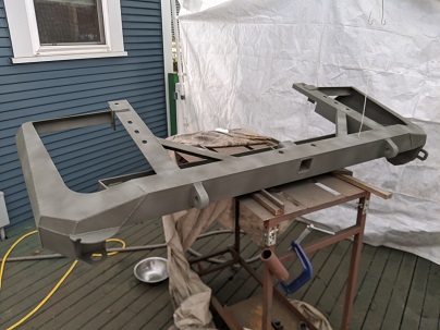

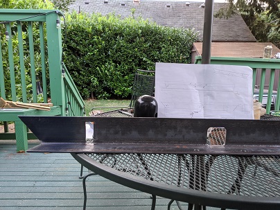

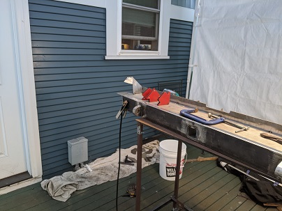

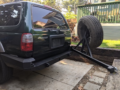

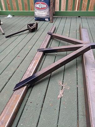

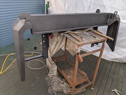

Thought I'd add my 2 cents.

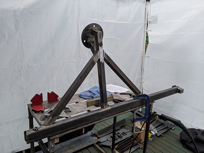

I built Bandit Runner's rear bumper this past summer (on my back deck, using mostly hand tools and a welder running off a 110v circuit). It was a lot of work, but VERY rewarding. I get a lot of compliments on my bumper, and people are always impressed that I built it myself. His plans are very thorough, detailed and easy to follow.
All of the plate steel parts I had laser cut at a local shop. I'm in Oregon, and there are a lot of small parts manufacturers and machine shops here. My local shop always gives me a great price. There are a number of parts (at least for the rear bumper) that are constructed from angle or tube that I had to fabricate myself ... this is where the bulk of my time was spent.
Here's a quick cost breakdown:
Bandit Runner's plans: $160
Laser Cut 3/16" plate: $276
Other Steel: $173
McMaster-Carr parts: $89
1 tank of shielding gas: $50
Other consumables (grinding wheels, welding wire, etc.): $40
Mounting hardware: $25
Paint: $40
Total: $853
I've been looking at kits for a front bumper ... I really enjoy welding, but I enjoy fabricating the parts less. Ultimately, I'm not sure you're saving much $$ going the DIY route, but you will have the pride of knowing you built it.
