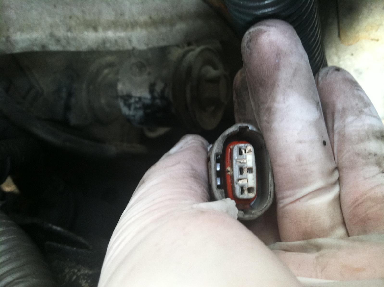

replaced my alternator with a duralast from autozone, in a 172k miles 1997 SR5. the 3 prong plug connector looks pretty shot. i've attached a photo for review. my battery light stays on, and i replaced the old one with a battery with 10 cold cranking amps less than the old one. guy at the shop said it shouldn't matter, but my real concern is the shot connector. edit: i'd like to add that my new battery won't hold a charge, even though i replaced the alternator. i'm not sure if it's a shot connector or a bad replacement alternator.

@%1;War Sprout
Curious how many miles you have on your truck. My alternator went bad on mine right around 175,000.
Mine went bad at 171k. Started the truck up, drove 5 mins to the gas station, pulled off to the side when I finished to wait for a friend, then nada. I could tell it was going because when I turned my lights on, the engine started to whine and act like it had quite the strain on it.
Re-man put in by my local mechanic, good as new. I wish I had this thread then, could have saved me a couple hundred bucks.
