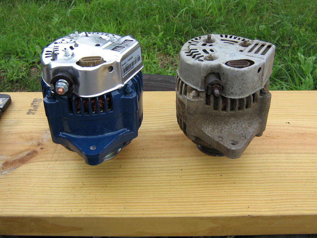

I wouldn't spend that much for 70 amps. I got mine from Quality Power, 160 amps for $300. Its a rebuilt Denso. I used caliper paint to match my calipers & drums.
