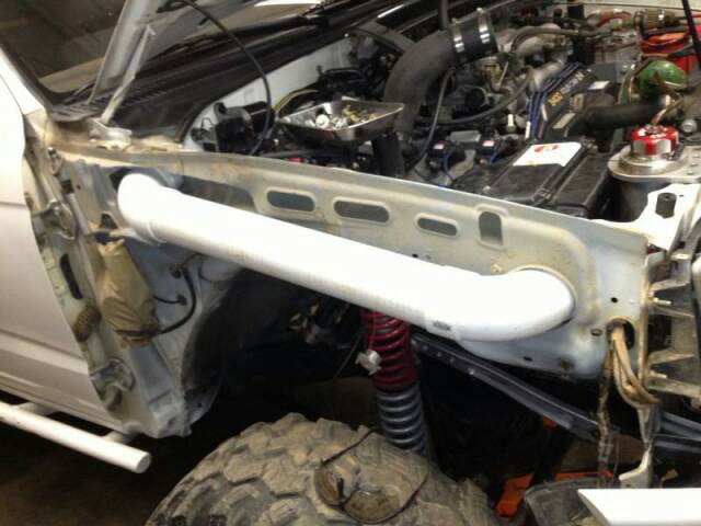

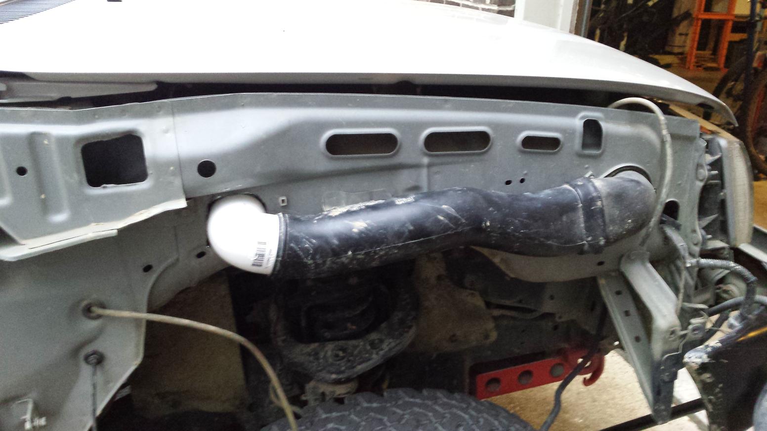

I did a super easy engine bay snorkel a few months back. I've never had water up there before, so it should work for me.
