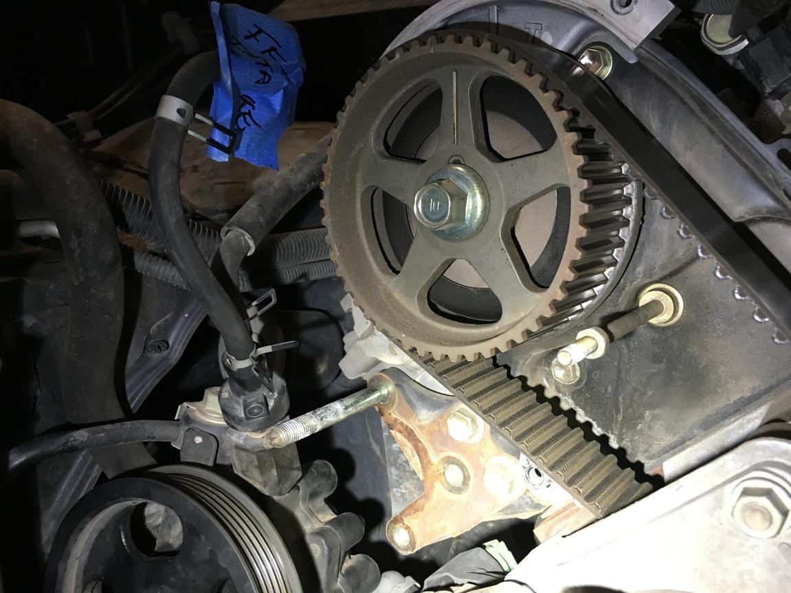

So to inspect the cam seals do I also have to remove the gear or just look behind it. I've got almost everything apart now. I don't see any seepage below the gear on either side and the Aisin kits don't come with seals. :shrug: so thinking I might just leave em but I am curious how to properly inspect.
Pic included of right side cam gear.
