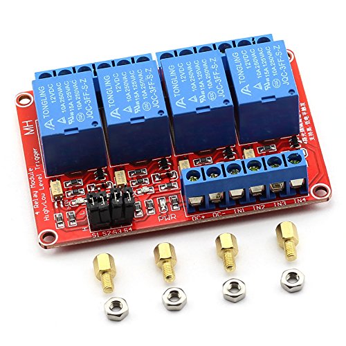

A 4 channel relay PCB like this costs about $10. https://www.amazon.com/gp/product/B071K7ZLYL/ref=ppx_yo_dt_b_asin_title_o06_s00?ie=UTF8&th=1
I don't have any personal experience with SPOD or other similar pre-made solutions. I imagine they are probably a good option if you don't mind the additional cost for a plug and play solution.
