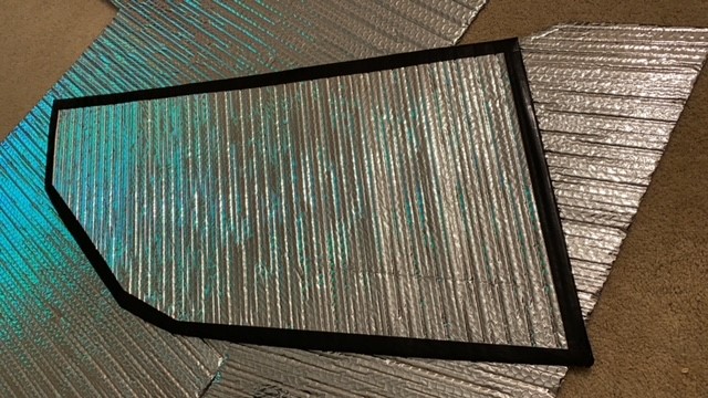

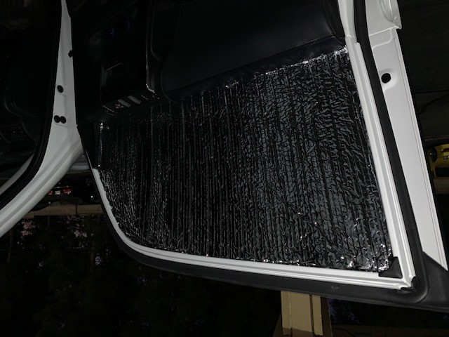

You can buy a roll of Reflectix from HD and then cut them to shape. I started by making templates from a roll of packing paper. I used the templates to draw the shape onto the Reflectix and then cut them to size. Then I trimmed down to perfect size by trial and cut method. If it did not fit, i found where I needed to trim and made the cuts. Once I had the fitment perfect, I lined the edges with gorilla tape. Worked great and kept most of the sun out in the early morning!
Total cost was less than $50 and maybe two hours of time. Good luck!
