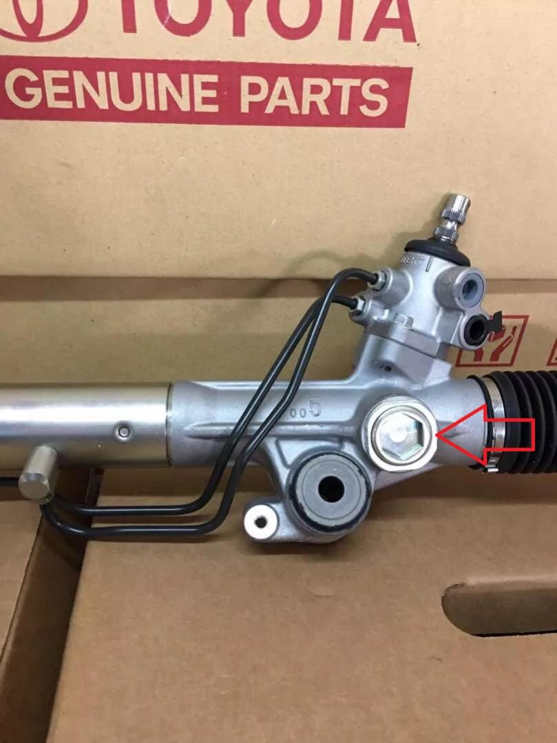

The fix that is used on the Lexus GX models per a Lexus TSB is to switch the spring in the steering rack to reduce feedback. This is something that I had an issue with in a 3rd gen 4Runner that has a very similar design and the same steering shimmy issue at times. On those you could just get underneath and actually adjust the spring preload in the steering rack yourself. It was pretty easy to do. On the 5th gen the adjustment mechanism is very hard to access. Unfortunately they should have fixed it when they swapped steering racks.

The Lexus spring issue cannot be fixed on the 5th gens. That spring is completely sealed in the power steering rack, therefore they changed my entire power steering rack.... no fix :boom:

The spring is not completely sealed in the steering rack. I don't know whether Toyota dealers can buy springs or whether the Lexus spring is the same for certain, but you definitely can access the spring in the rack. The arrow in the picture is to the cap where it is located. It may be nothing more than a bandaid to put a heavier spring in there, but that is what Lexus did. The steering racks are the same. The same part number is shared with lexus depending on model year. There are about half a dozen variations in part number that are superseded by the current version. They should all be interchangeable.
Also, if you didn't know - all GX460s have KDSS and still had the same issue, so it also does happen with KDSS.

Thanks for that info, I will be printing this out to take to the Toyota NA Tech along with the the PDF on how Lexus replaced it.
