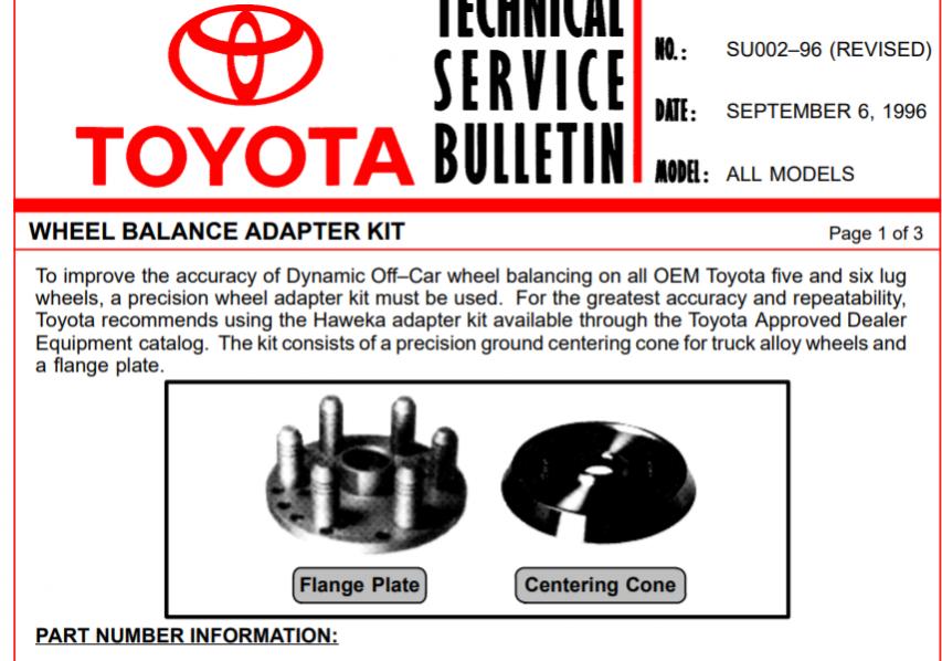

To get get the perfect balance and zero vibration the follwing steps must be taken:
1. Haweka adapter to get the proper centering. If you see a tire tech that keeps chasing weights then the tire is not properly centered on the balancer.
2. Road forcing balancing. 10lbs or less of road force is a must to get zero vibration. If you get high road force readings, the tire must be indexed on the wheel to get the lowest road force or the tire may need to be replaced. The default road force limit is 25lbs for p-metric tires on the Hunter GSP9700, but a lot of lazy techs don't bother to index the tires as long as it's anywhere under 25lbs.

My 5th gen does not have any steering wheel shake. My 3rd gen had it at 60mph just like the 5th gens have. The solution for the third gen was this finger plate adapter. Use this during balance. I don't believe road force is necessary. Use the finger plate adapter and the corresponding short centering collar to mount the wheel flat to the balancing machine. Also a good idea to clean/scrape any rust etc. off the wheel hub, where the wheel studs are before remounting the balanced wheel.
May want to bring in this TSB and ask what they think about it. attached as a PDF below
