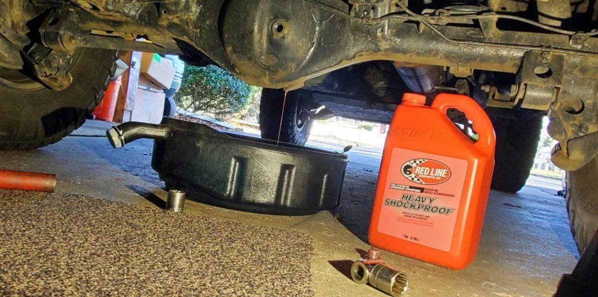

I have been using Redline HD shockproof for the last 15k of offroading and road tripped miles with great results. Changed it recently and it came out looking as good as new.
