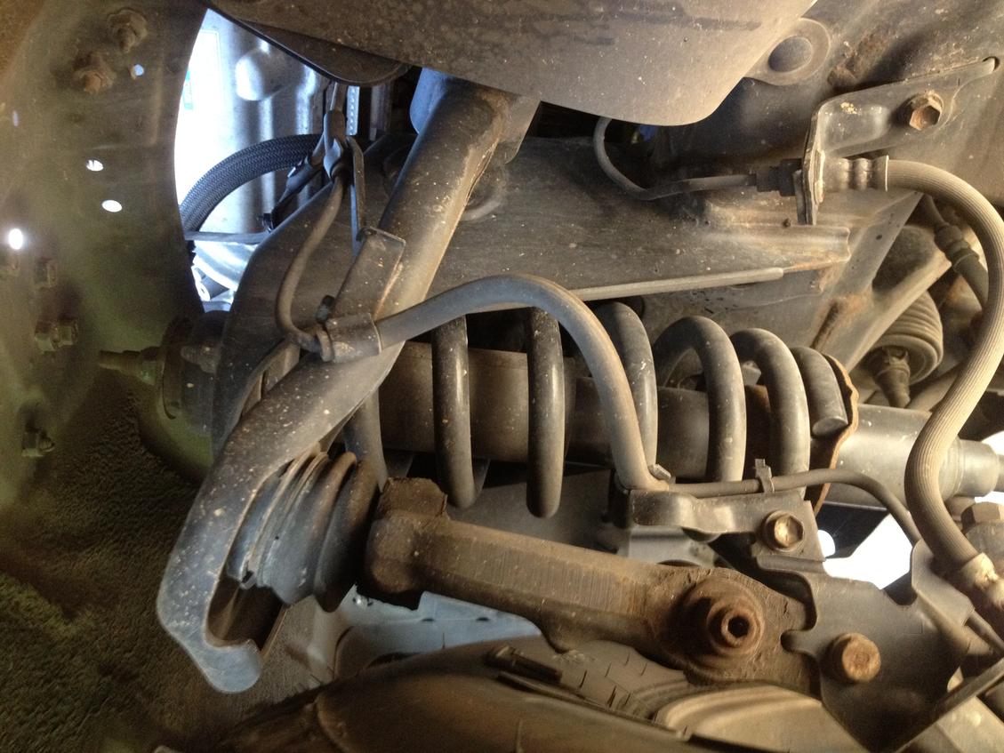

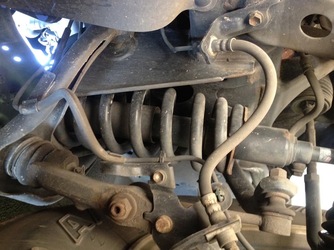

do i have xreas suspension?
zu13
i do not know how to tell if i have xreas suspension or not. i am pretty sure i do not because there is not any tubing going to the top of the shock. But i am just making sure!!! thank you for the help!

It looks like there is a line at the bottom of the shock in this pic...
Look at your frame, there should be a box there with lines coming out of each side and running along the frame. If there is, you have Xreas.

Yup, just pull it. It's in no way connected to the electrical system or anything else that would give feedback to the rest of the car. Just pull off the Xreas and install your stuff. If you search for removing Xreas you should be able to find some thread with pictures.
Edit: Just looked at some of your older posts and in one of your firsts you mentioned that you have a Sport Edition. Xreas was standard in Sport Editions so there's no doubt you have it.
