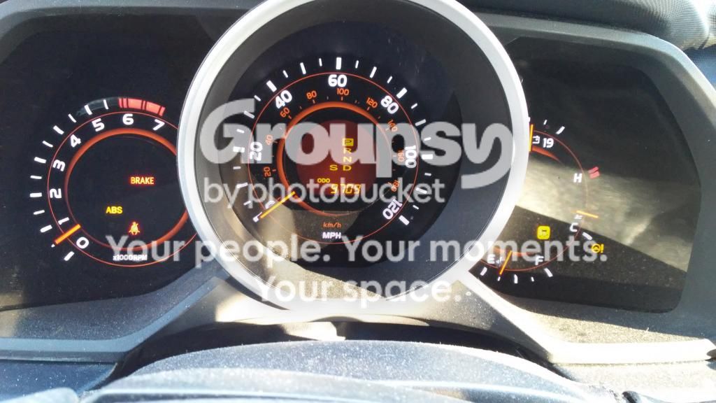

Something strange started a couple days ago, just after a bitter cold snap. I started seeing the ABS light (on left) an the Tracking icon (on right). I really thought nothing of it at the time because I understand that circuit boards are sensitive to temperature (extreme temps in particular) and it's been very cold here; on the order of 20 deg f and I haven't used the vehicle since Mon or Tuesday. Today however, not only did I see the two warnings mentioned above, but almost all the other instrument monitors e.g., tachometer, engine temp gauge, fuel econo gauge... etc, were going crazy; the tach was spinning like a top, pinning at both ends of the scale! 'see below':
See ABS and BRAKE warning on the left, on right (above fuel gauge) see yellow 'Tracking' and 'small circle!' icon.
I noticed it when I was going to the supermarket. What I thought to do about it was, I 'disconnected' the battery before I went in the store; hoping that after about 30 mins, things may go back to normal... "that wasn't the case!" I'm not too worried about it, I'd just rather not take it to the dealership; remember I'm suing them for my 'Entune" problems (and for lying about it) and I really let them have it in my last email component!

I had the same light sans ABS. Was fault codes in rear wheel speed sensors and the steering angle sensor. Cleared at dealer and nothing back on since. The computer stores codes until they are cleared using techstream. If you know anyone with the software you can check it out and if an inactive code, clear it and keep going. If it's active, more digging....
I'm curious, since your having so many electrical issues at once, if your battery connection is good. Is there a chance with the cold weather you might be either getting a marginal connection at the terminals? Check battery voltage, see what it reads with static load, then recheck with ignition on without engine running. My guess is that if your down around 11.7 the cold weather is exacerbating the situation.
His battery gauge looks normal to me. And should be at max based on how the LE gauges work/look.

Idk. Mine happened going down a steep grade into a tight turn at 80mph in about 65 degrees. I've been in near zero and no problem. They are sensitive to dirt/mud but sometimes codes get thrown. Won't go away until cleared. If you search you'll find my thread on the problem from about two weeks ago. I called it VSC light or something like that.
Hey riggo,
I'm going to gently pick on you here. But that "circle with an exclamation point" is your power steering warning light. I would first check the fluid level and make sure it's good. I don't believe our trucks have a p/s fluid low indicator like GMs do.
And error codes are because of the sensors they are reading. Traction control, ABS, speedo, downhill assist, etc. are all affected by the wheel speed sensors.

Oh, didn't think about it but I didn't have the PS light either. Check the resi!
Nothing in the 4Runner is that sensitive to the cold otherwise it'd constantly happen to everyone in Canada. 20 degree F temp drops overnight are nothing compared to the 20 C temp drops we can get up here (20 C change > 20 F change).

It kinda looked like a steering wheel; never saw that before. Power steering is just fine, but ALL of my warning lights were coming on at some point, that's why I thought about having a Priest/Rabbi come and Bless it for me! lol.
"...And error codes are because of the sensors they are reading. Traction control, ABS, speedo, downhill assist, etc. are all affected by the wheel speed sensors."
I know you're right about that but even the Tachometer and Fuel Econometer were rolling like we were in a horror movie sooo ...wazzap :noidea: hahaha!

Curious as what codes are being thrown. In the meantime, check all the grounds ( body, chassis, engine), and check battery voltage (engine off, while starting, running). 20°F is nothing. I've had my 4th gen in temps as low as -30°F without any issues. I'm sure the 5th gen is just as rugged in low temps.

Battery, charging, cabling is fine, I questioned why this happened the same day that it got very cold; just considering all possibilities!
