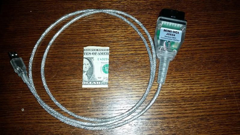

well when I bought my cable, it came with a mini cd, that was the hardest part, getting the files off the cd to the computer to install. it had a s/n on the cd to install techstream for unlimited use.
also be super anal about the install, those cd's come with a boat load of virus/malware. scrub the crap out of it since most of these come from china/etc.
but that was an old version so I cant say how the v9 works or how it installs now compared to v8.
forgot to add, the whole works came out to about $25-30 usd shipped. since I was adamant about buying from a usa business, I had recourse if it never shipped or whatever. if you buy from amazon/ebay expect the ship time to take forever since they come by slow boat from china :) nice pun there literally.
attached is pic of the cable.
Another reason for the VM install. The Chinese malware can do its worst to my never network connected VM that only exists to run techstream.
