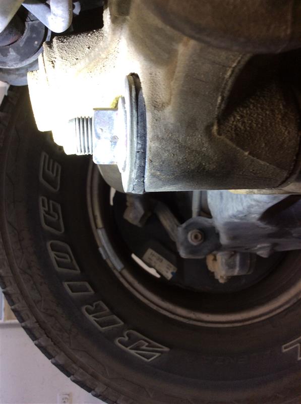

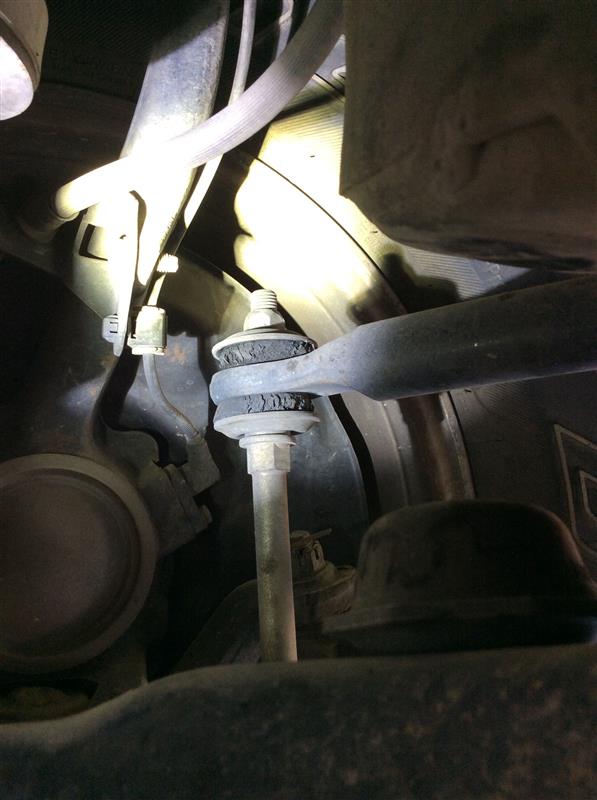

I had my car in for an inspection a couple weeks ago. they took these pictures and attached them on the email inspection report. said I should replace my tie rod ends and replace rack and pinion. I can change oil and brakes but don't know jack beyond that. the car is somewhat bouncy too on fwy going 80 over big bumps.
from these photos, do (whatever these are) look worn to where I need to replace? they also mentioned ball joints needing replacing down the line. what should I replace for SAFETY purposes? I don't really care about anything else as long as it's safe. not trying to drop 2 grand on suspension or have the best handling ride. thanks!! :)

The first picture are the sway bar link bushings. Those go bad frequently. They are 2$ at the dealer. That's not the tie rod end.
Second picture doesn't help much as far as diagnosing the rack. Usually they leak from the boots covering the inner tie rod end. You can't see that from your picture.
From the second picture you can see the lower ball joint but not much of it.
Definitely do your lower ball joints for safety. Only OEM. People have had issues with other brands, they don't last
Do your front and rear while you are at it. The fronts have the 4 washer-type bushings and one large "D" shaped bushing. I just took the whole sway bar off (the large metal bar attached in the first pic), makes it easier. Rears are the same but some models the sway bar does not come out. Will take out a whole lot of body roll that you are experiencing.
Looks like the shop told you one thing and showed you another. Like what was said by stir_fry_boy, First pic is sway bar end links. For the second pic, If they are telling you to replace the rack because of a what looks to be worn bushing don't go back there. There is a bushing kit you can get at wheelers off road and plenty of how to threads here. I also agree with replacing the LBJ's.
