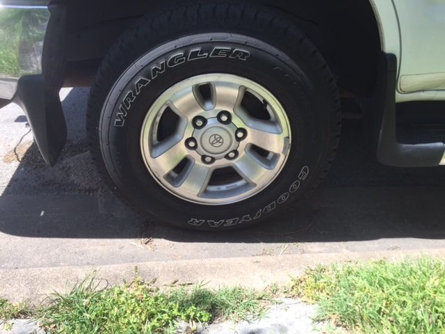

I have a 2002 with 15" Rims. I will probably tow a small 2000lb (Max) trailer in a few years... when I finish building it. My brakes seem fine. On the advice of my very conservative old mechanic I switched to Toyota rotors and pads and that got rid of all the vibration... been a year or so.
I've been reading and reading and it looks like the 199mm upgrade is really all about heat. True?
1. Do the 199mm actually add any breaking power?
2. They just bolt right on right? Check out my wheels.
3. There are NO 15" wheels that will hold the 231mm. Right?
Thanks

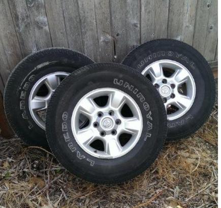

Gotcha. Well, I woooulllld do the 231's in 5 years... when my brand spanking new tires give out... in that case... I was reading the 231mm thread and these are the rims I want... I think they would look best for my year. IMO.... These are Tundra... that's all I know. If I knew what to call them. I'd look for them? Ask around?

i did the TBU when i had stock 16" star wheels. i upgraded to 17" 2014 4runner wheels. the 4runner rotors are thin and weak and can't hold heat. they warp quickly. i went through 2 sets in my first 4runner. when i bought my current 4runner, i upgraded. they do add stopping ability.

Yes but of course not as much as the 231. If you do go with 199 for now, get centric brand (or oem) that are at least drilled (ebay/amazon). They'll stop just fine around austin. Where they really help to dissipate heat is on hills (while towing) and especially mountain passes (with or w/out tow). They have more than enough stopping power - I've never had an issue and you know how austin rush hour is on 35!
I think the 199s only came on runners with 16" wheels, probably cuz they don't fit on 15s? (someone else help me here if i'm wrong). Luck!
