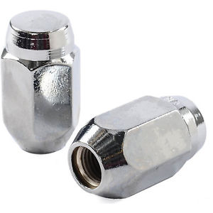

Do you guys carry six 21mm acorn type lug nuts for the spare steel wheel?
A great question. I have neither any documentation nor calculation to back it up. My 2014 Camry LE came with steel rims and had acorn lug nuts. I bought SE rims for my Camry and had to buy a set of mag type lug nuts. As far as I can tell (with my untrained eyes), the spare steel rim looks same as my steel rims. I am not sure what calculation I can perform (even if I were smart enough to do that). The mag type lug nuts are the best fit (IMHO) for Toyota OEM alloy rims but not necessary true (IMHO) for the steel rims. Coversely, acorn lug nuts will not be best (IMHO) for Toyota OEM alloy rims. I know there is no math behind this but please try a mag type lug nut and acorn type lug nut on a steel rim and tell me which lug nut type you prefer holding on the wheel. If you know how to perform calculation, I am willing to give it a try but you will have to go easy on me.

I see your points. What it bothered me was the contact surface area. I know there is conical seat profile on Toyota OEM mag lug nuts but my untrained gross visual tells me that acorn lug nuts seem to give more contact and less chance for mistake. Interesting the owner's manual tells you to torque it at higher setting: 82 lb-ft for steel vs. 78 lb-ft for aluminum.
If the ID is the same (bolt dia), the angle is the same, and the OD is the same (hex dia), then how is the contact area different?
Steel/Steel has a higher coefficient of friction than Aluminum/Steel, so you'd want a higher torque on to achieve the same preload.
If you look at the acorn lug nut (as shown in the first post) the taper section is a bit deeper compared to Toyota OEM lug nut. You are correct if the contact surface area is the same then there is no difference. I have not painted the lug nuts and compared the difference in the contact surface area. This is not hard to do. I agree with you in that you are not going to have any issue with OEM lug nuts with a steel wheel. I personally feel more comfortable carrying six acorn lug nuts in my glove compartment in case I have to deal with a flat tire in Montana or North Dakota.
