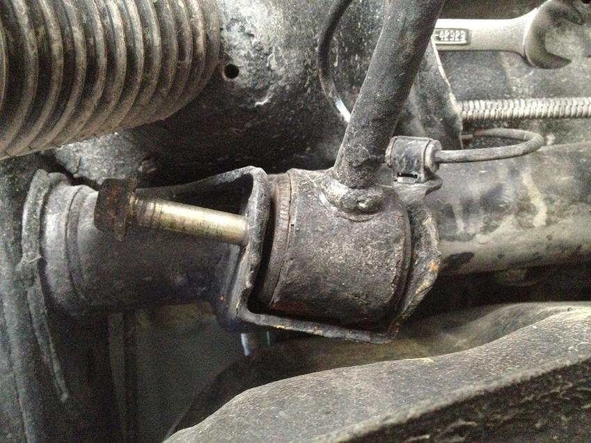

I definitely check after I do a hard wheeling trip. After my first trip, which was my first hard trip since I installed my lift, I started getting some ugly sounds coming from down below and I figured out the top of my rear shock (the nut) had come loose and was rattling. So I'm down there tightening and lo and behold what do I see? One of my rear UCAs was about to kick its bolt and run free. Like stated above I added some blue loctite and I have no problems now.
