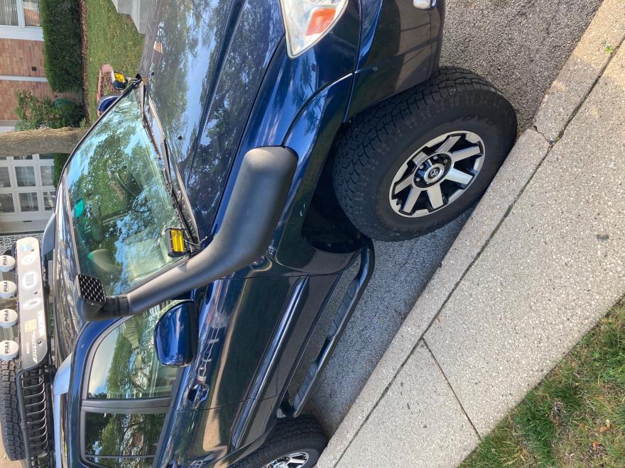

I spent the past few days doing some basic prep work, then spent a good part of the day today installing my Dobinsons snorkel. I’m not a fast worker - it took me a lot longer than the 3 hour estimate in the instructions. I don’t mind going slow and making sure I do everything correctly. My time also includes breaks for cold water/Gatorade/etc. and looking for tools.
I’m happy with the results, the way it looks and functions so far.

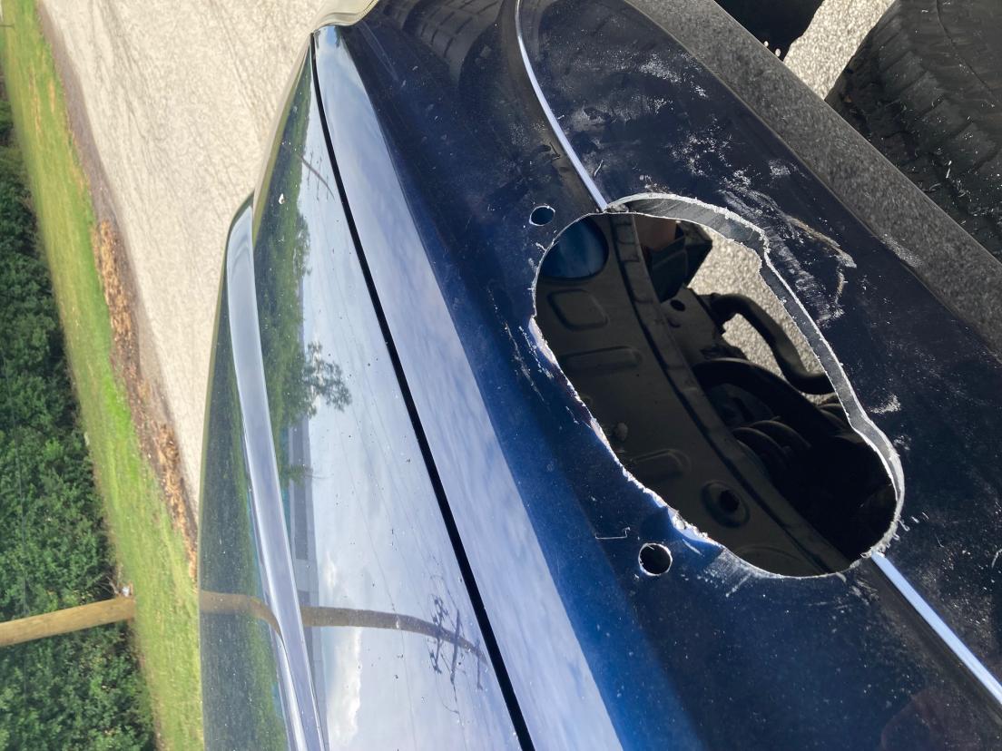

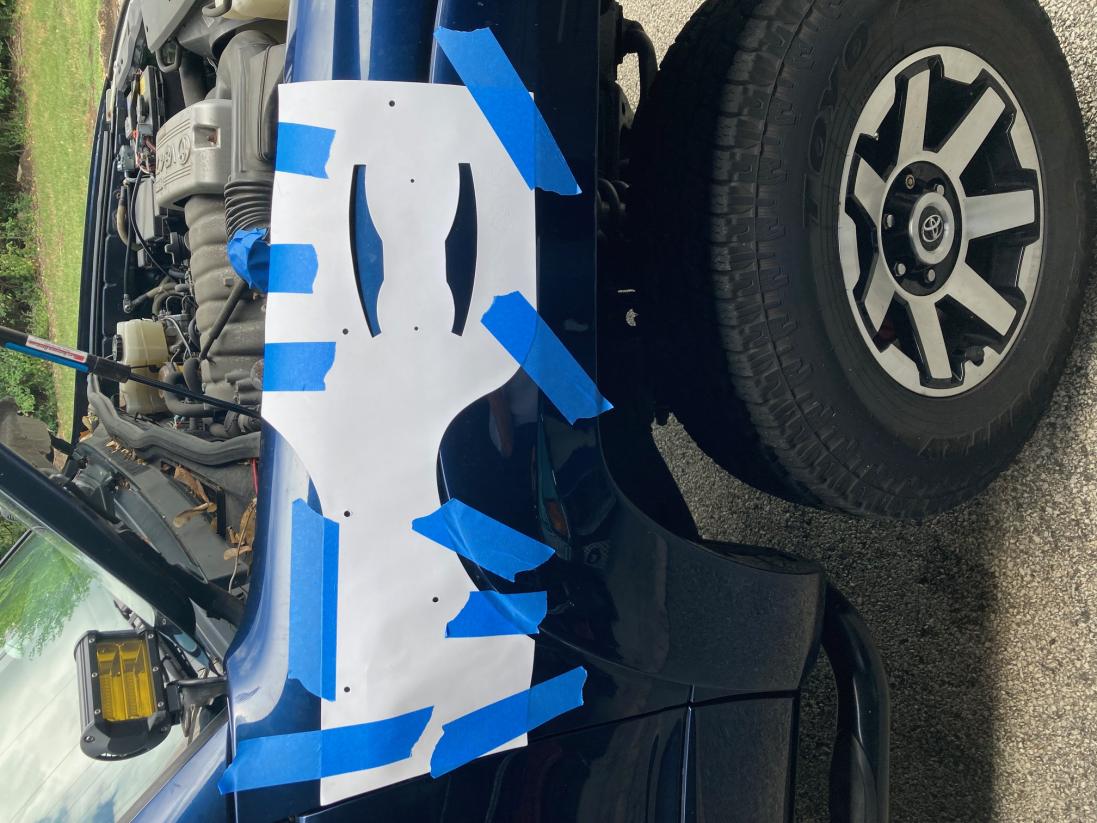

Like I posted yesterday, I installed my Dobinsons snorkel.
The instructions are actually very good, so I decided I would just add my comments relating to the installation and the provided instructions. I only took a few photos that add to the instructions. The rest are pretty much duplicates of the Dobinsons photos.
There are 39 steps in the Dobinsons instructions, and I will be referring to those steps.

5. It took me a couple tries to get the template lined up on the fender so that the top and rear edges matched the fender perfectly.
6. I used a red marker to mark the curves on the fender.
7. I used a 9/64” drill bit for the starter holes.
8. I used a 1/2” drill bit for the 5 holes. I was too cheap to buy a step drill bit, and 1/2” was enough, no need to go to 16mm.
9,10. Nothing to add. My hole saws got stuck a few times, maybe because my electric drill wasn’t strong enough.
11. I didn’t have a narrow blade, so my curves were not perfect, but close enough to work.
12. I did minimal deburring

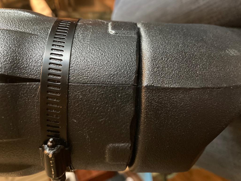

29. The rubber joiner hose is a very tight fit in the hole between the engine bay and the fender well.

33. I tightened the nuts completely right away - I didn’t keep the snorkel loose. I have long arms, so attaching the nuts and washers was pretty easy. To help me muscle the rubber joiner hose to the snorkel body more securely, I removed the right front wheel.
