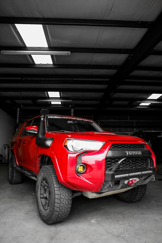

My install involved a ~13 hour round trip drive and a hotel stay (he started on the truck before 8am, and I didn't want to leave at 2am and come back the same day so I drove down the night before). That being said, I didn't drive down just for the snorkel, they also did my lift, skids, and some odds and ends. It was absolutely worth it and they solidly won my business for everything I can get through them

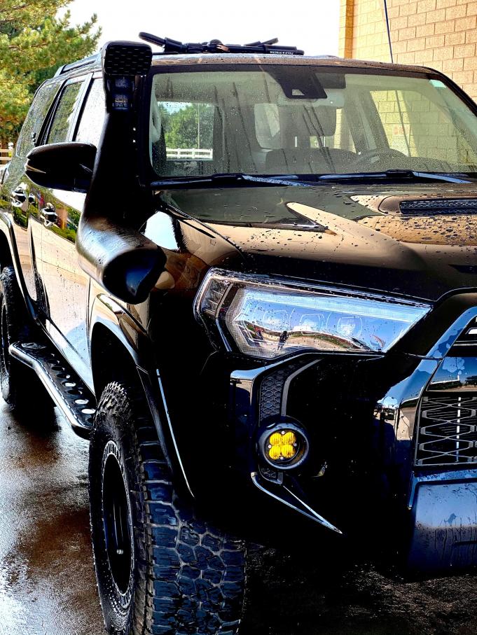

An update. Received my Dobinsons snorkel yesterday and installed it today. It's a straight forward process. Not difficult at all when you take your time. The most annoying part was nearly breaking all the fender/lining clips and grommets so I'll need to buy replacements. Using a dremel and cutting disc made easy work for the big hole.
So the Dobinsons snorkel has been out for two years now. Any long-term reviews regarding build quality? Especially exposure to UV and wet conditions?
I’ve had mine installed and in all weather conditions for a year and a half now. The truck is always outside. I’d say mine has faded especially looking back at the new pictures in this thread. I just ordered up some plastidip that should match my silver nicely. I’m going to try to dip it to see if I like the look better before buying a new fender and eliminating this from my truck. It’s my biggest regret for sure. I’m still getting moisture into my airbox so I don’t know if the rain channels on the snorkel head aren’t doing their job properly or what.
If I’m getting enough water into the airbox for it to collect with the drain hole plugged then the snorkel isn’t doing it’s job. I may be getting cleaner air overall but the trade off is significant.
