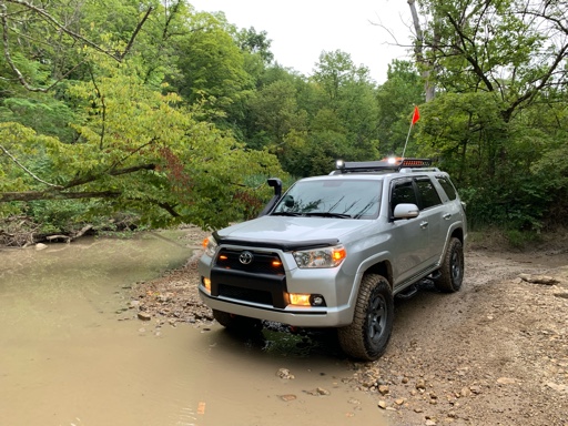

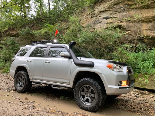

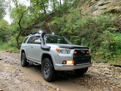

Few pics of my first time out with the snorkel. I hit some water crossings that would have had me nervous before. Now I’m care free and loving it. IMG_2242.jpg

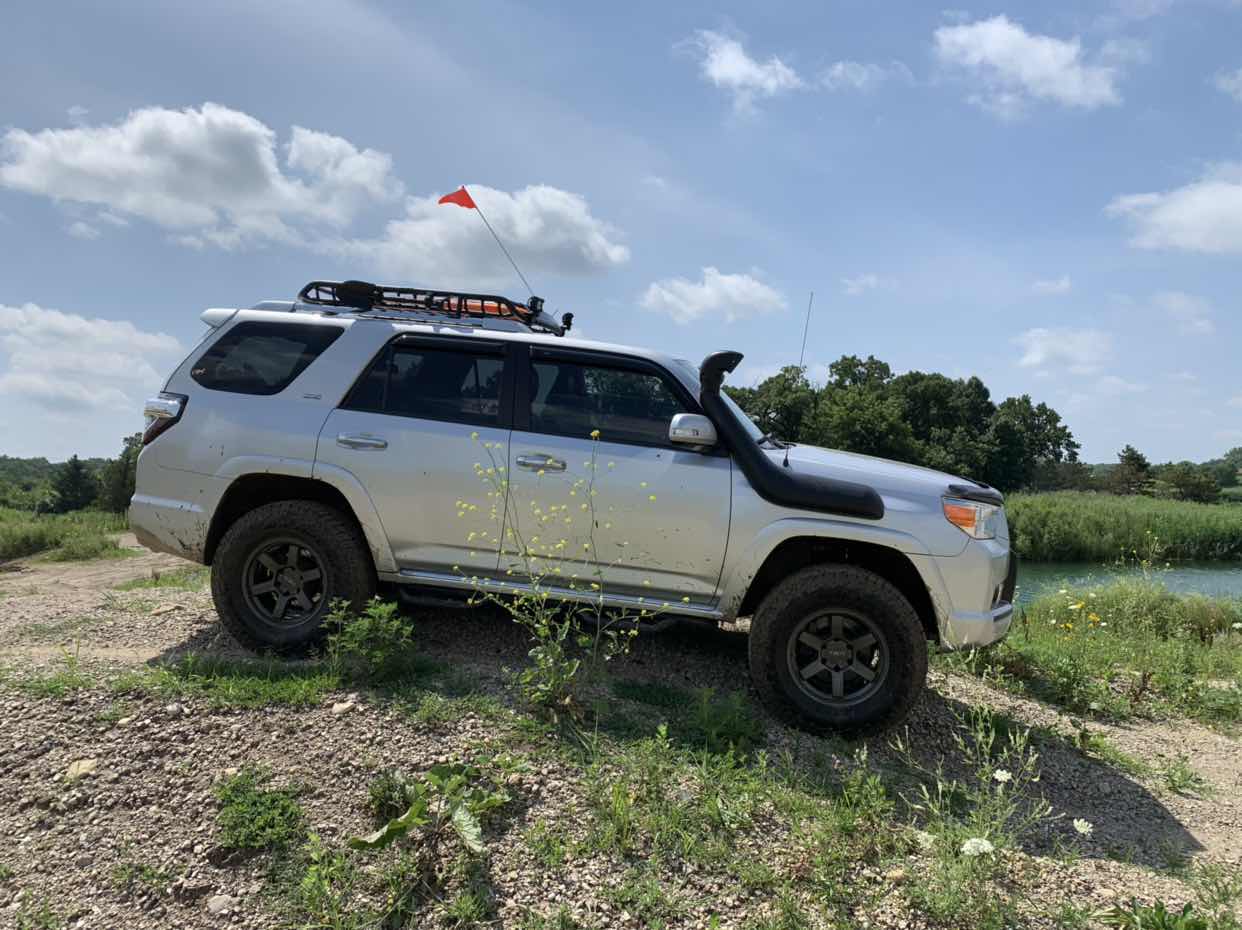

Great to see the snorkel on a 2010. I had wondered if the antennae on it would get in the way of the install as I have the same year model.
I had the same issue and I couldn’t find many snorkels on a 2010-13. The only issue with the antenna was squeezing my hand up to reach the highest mounting points in the fender well. That’s a tough one and will likely invoke some swearing and a sore hand since getting around the antenna mount is a thing. I didn’t have to modify anything though so that was great!

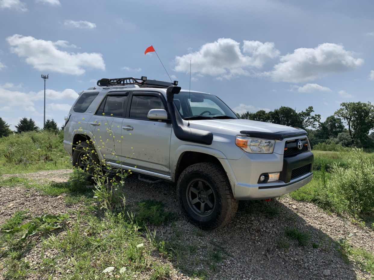

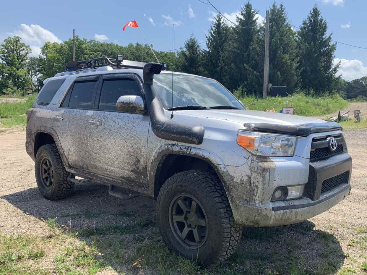

I’ve used the snorkel in actual applications where I would have had some genuine concern about ingesting water so it’s been great. We just got our first snow so I’m curious to see how that pans out. I know I’ll have to turn the head backwards which I see a lot of guys do anyways in the desert and in Africa just to cut down on dust flying directly into the intake.
