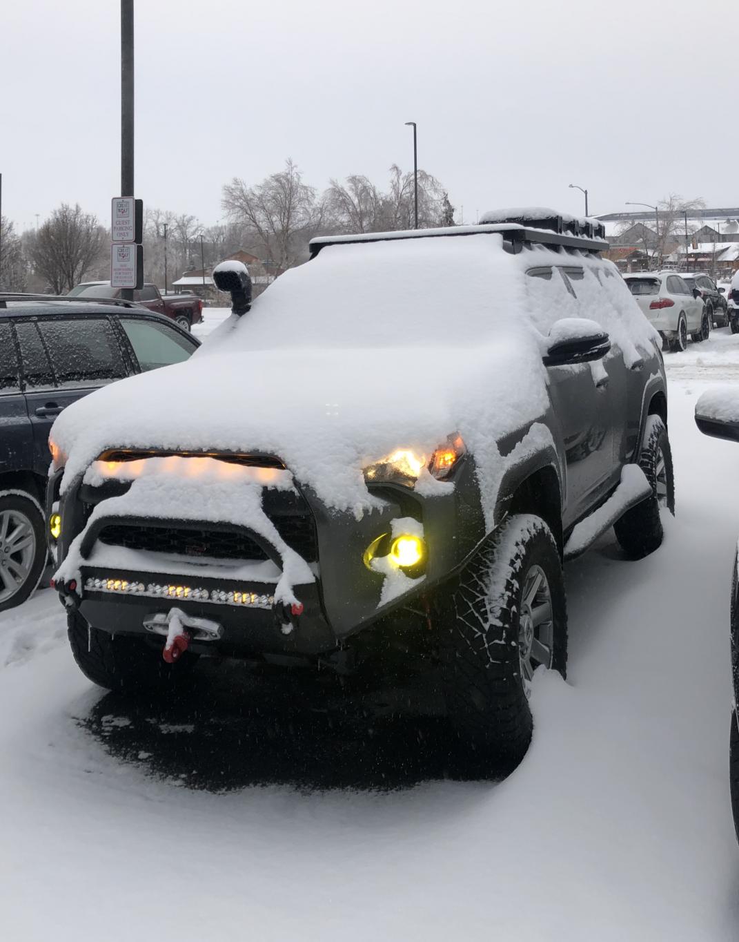

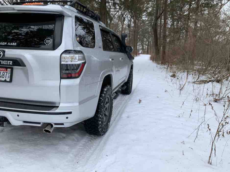

No driving photos, but this was it in the morning.

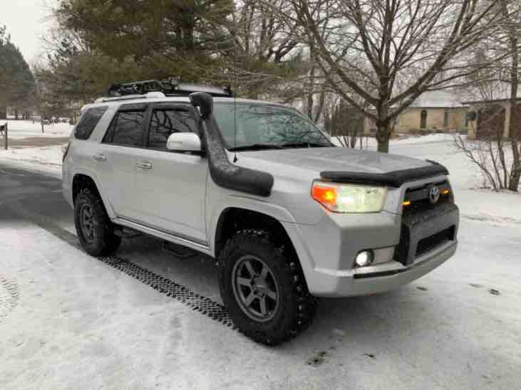

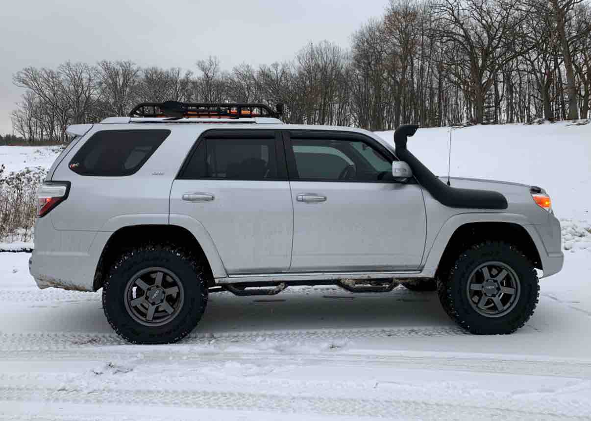

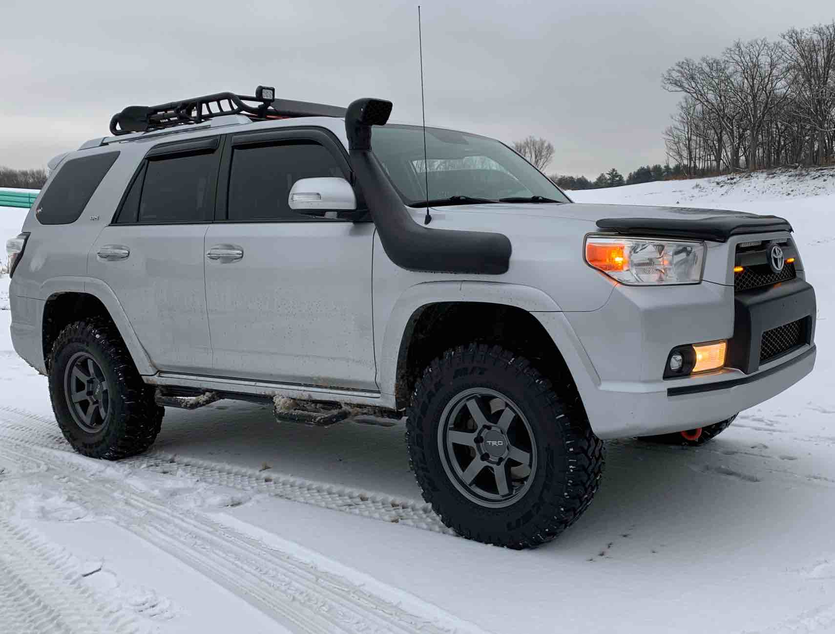

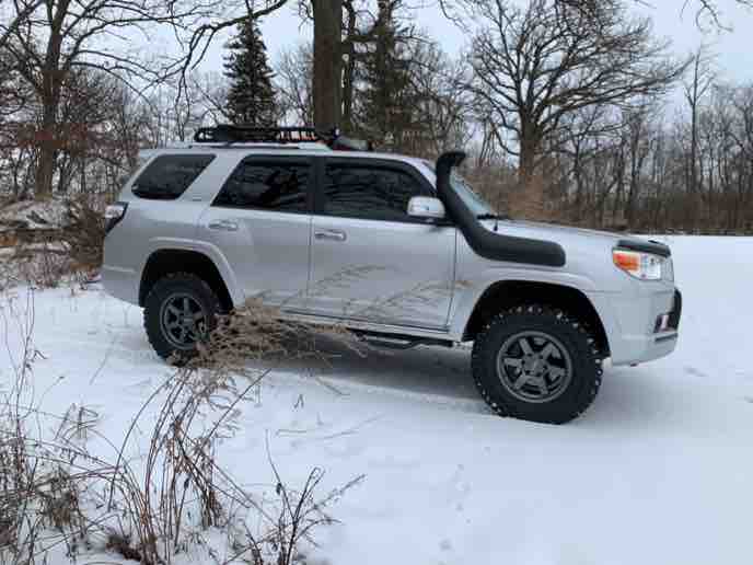

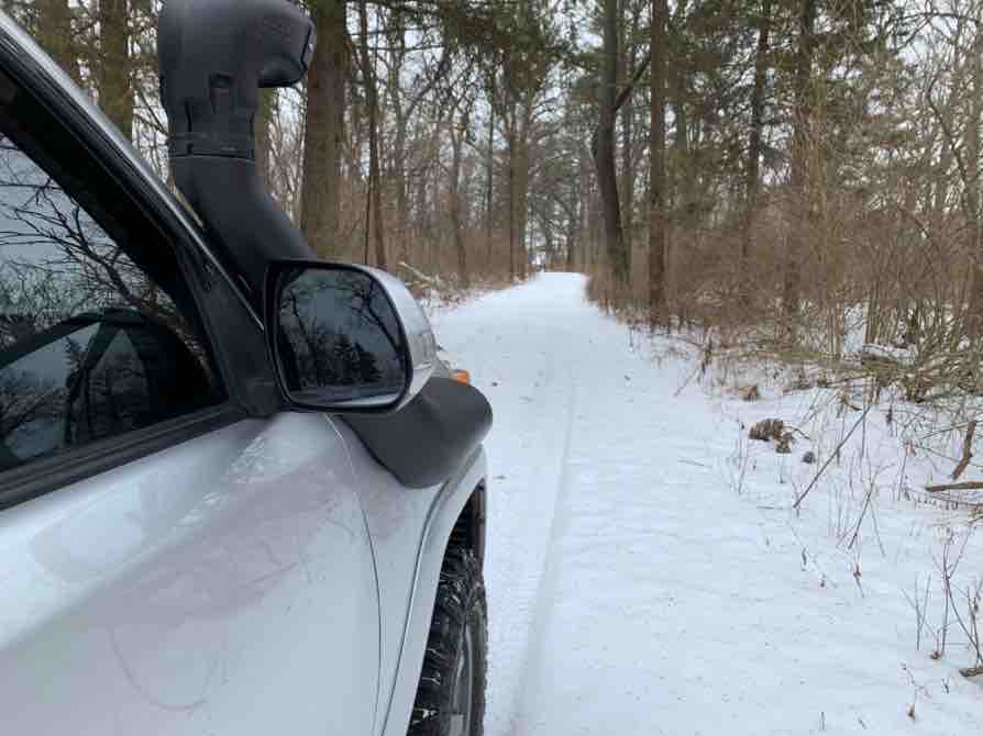

Here’s a few snow shots from yesterday for the membership (not for official marketing).
I’ve taken to flipping the head around in the snow. You could leave the head backwards at all times if you really wanted to. I’ve noticed some water collection in the base of the snorkel tubing but none in the airbox, which is the point of the snorkel. The water in the snorkel body seems minimal and likely evaporates fairly quickly in dry weather.
I riveted the a-pillar as advised by the instructions and I’m glad I did. After several road trips, I don’t want to worry about it breaking loose at high speeds with a head wind.
I’m considering painting the snorkel silver to better blend with the truck. I’m on the fence and may plastidip it first in case I don’t like the look.

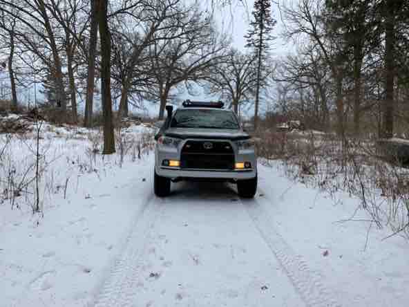

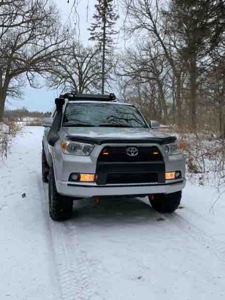

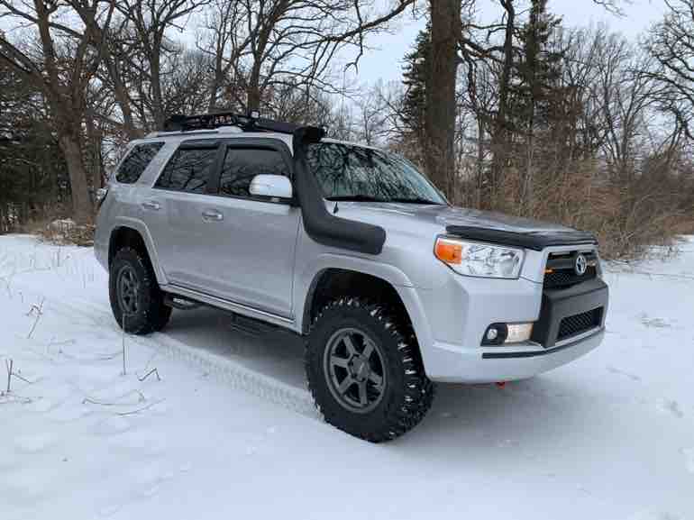

Few more snow shots from today...wish it could have been more scenic but oh well.
Snow mode with head turned...

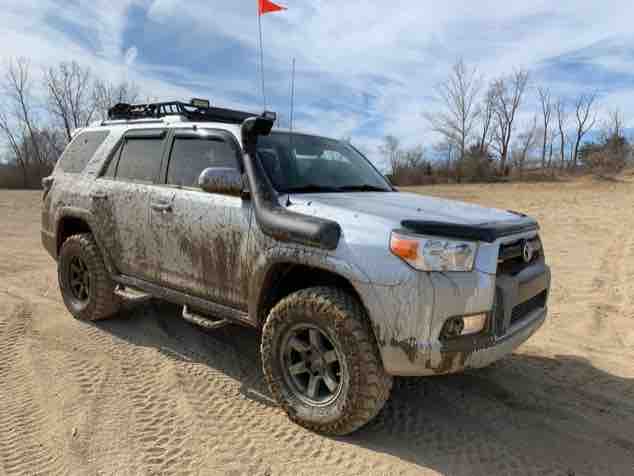

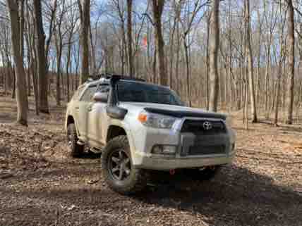

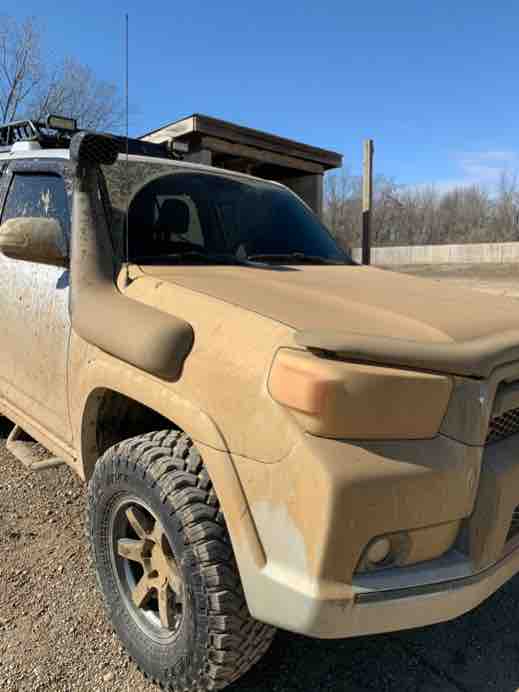

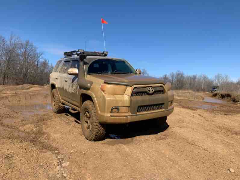

Put her to good use yesterday. She earned her place on my truck, especially in one puddle that was halfway up my door. IMG_4678.jpgIMG_4675.jpgIMG_4646.jpgIMG_4664.jpg

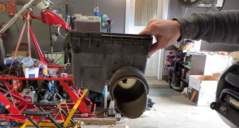

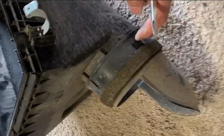

During the installation process, has anyone taken a photo of the air intake side of the original air box?
I'm trying to see what it looks like compared to an AFE CAI kit that someone has. I'm pretty sure the shape is different.
Nevermind, I found it in a video.
So for anyone else asking about using this snorkel with any other CAI (cold air intake) kit, that part needs to be round for the hose to attach properly from the snorkel to the air box. If it's round, you should be good to go.
When I installed the snorkel, the Dobsinson supplied hose was a very snug fit onto the stock intake hole. Took a little bit of effort to get it on. If the intake on a CAI has the same outside diameter (or slightly smaller) as the stock, it should fit fine. Definitely worth the extra time to measure the OD of the CAI intake and comparing it to the stock.
