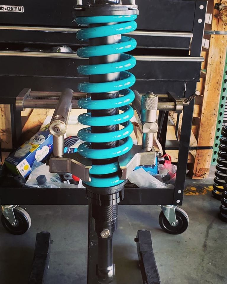

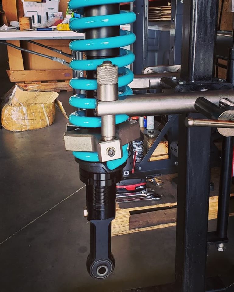

Those who ordered first receive first!!! First set of assembled Dobinsons IMS struts and shocks going out the door yesterday.
