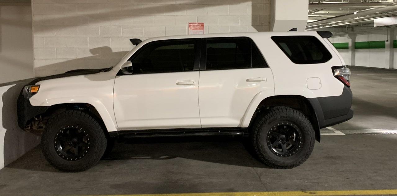

Alright I’m trying to figure out why my truck is still sitting with a noticeable rake after dropping the rear to a 1” spring.
C59-302 up front should have me at 2.5” I’m not convinced I have 2.5” up front at all tho.
C59-599 in the rear should be around 1” which seems right.
Seems like my front is more of a 1.5-2” lift.
What gives?

Hmmm that doesnt look like 2.5. I have the 300s in the front and they seem to be taller than that. Definitely get those fender to hub measurements
I’m at about 20” on the passenger and about 21” drivers side. Looks like I have a 1 inch spring if that.

Here's a pic of the wheel gap for my 2.5" lift in the front for comparison, if it helps.
Pretty noticeable difference. 1” spacer lifts I’ve parked next to seem to have more fender gap.
