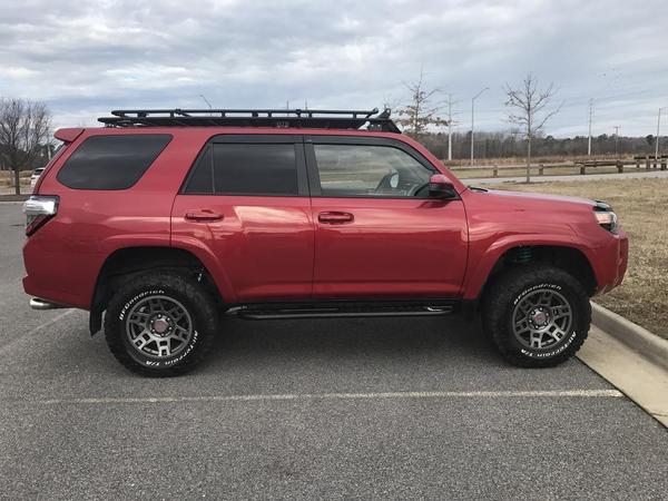

On and off-road changes drastically for the good. Nose dive and roll gone, on ramps to the interstate improve. Only off-road I have is beach ruts, gravel roads with holes that you would slow down in a stock ride. I feel the more speed you have the better the float. Didn’t install the UCAs yet. Didn’t have them initially during the install and alignment was no issue. They are in hand if the ride gets squirrelly.

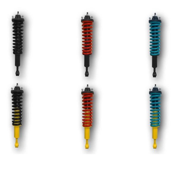

Just added this photo to the first post to show the 6 different color combinations Dobinsons has, depending on the coils chosen.
Thanks and the pic helps.
By chance have you measured the achieved lift front to back? It looks like you may still have a little rake which is what I would prefer to keep, but maybe not the 2” difference I currently have with stock.
No measurements taken. I’ll grab some to see if there’s any difference. I’m sure there is. I think 505s is want you want. 325 is what I want to move up too. I have different weight issues, having the 3rd row, heavier spare, rack, sliders, skids and lots of kids. This setup still allows 285s with the right offset. Trimming was minimal to the front bumper. Shaved less than 1/4”. FN pro wheels are fine, I mounted SCS wheels and had all types of rubbing.

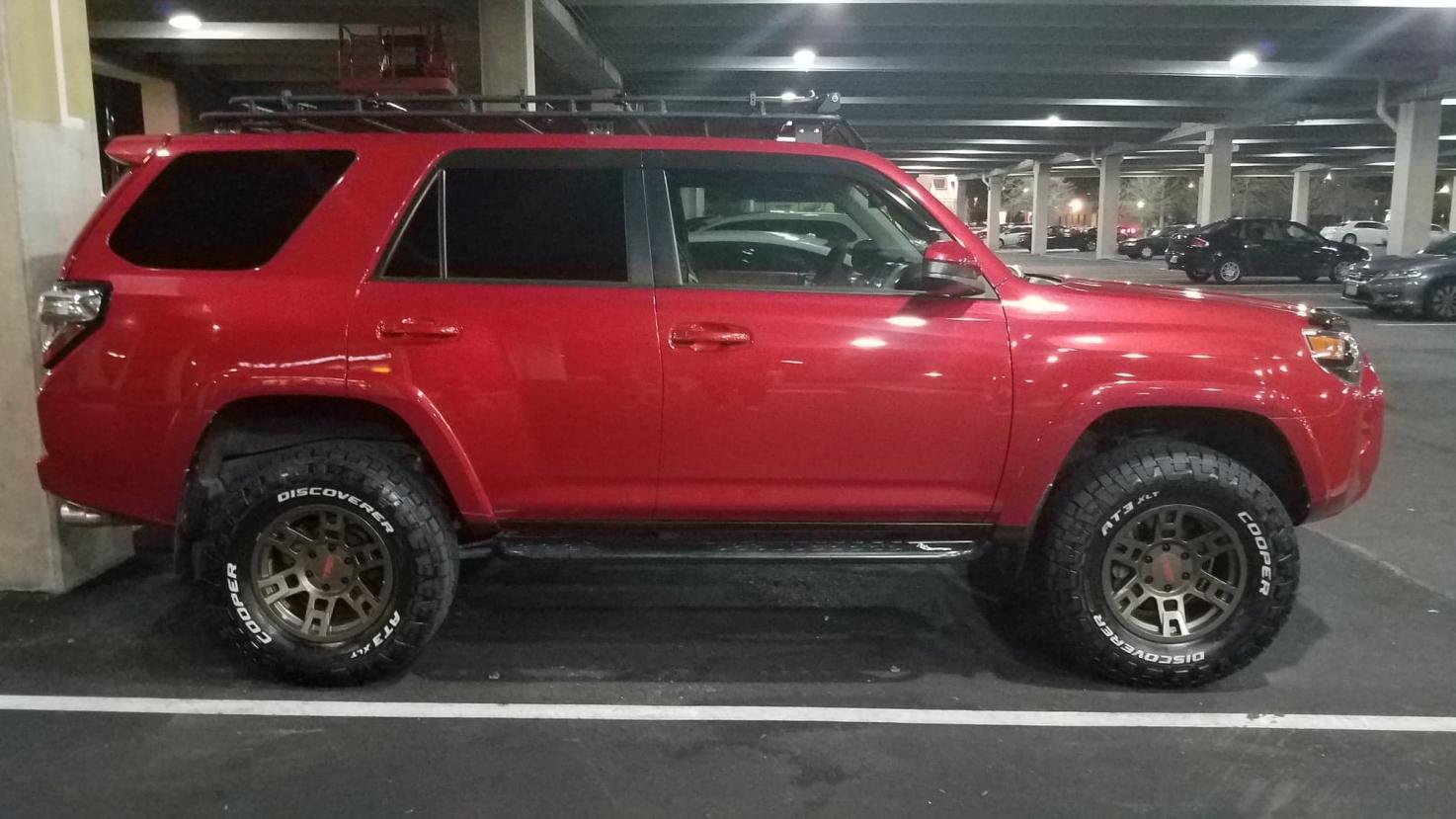

That’s with 265s and OEM TRD wheel’s offset. No rubbing or trimming done.
