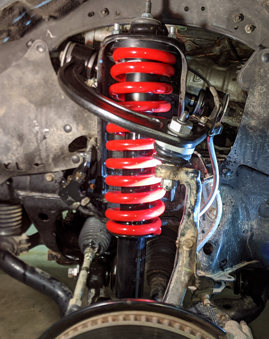

Installed C59-302/GS59-700, C59-325/GS59-701 on my 2017 TRD Off-Road w/KDSS. Took it out for a shakedown and nothing fell off :)
After settling, the truck is sitting 2.5" higher front and rear. One side or the other can be up to an inch higher than the other, but that seems to be the nature of KDSS as it behaved the same way before the lift. I did install a 15mm spacer on the right rear.
I had to buy most of the tools for this project, but the opportunity to work on the truck is one of the reasons I bought the 4Runner. Here are the instructions and notes I prepared for myself. I installed SPC upper control arms.

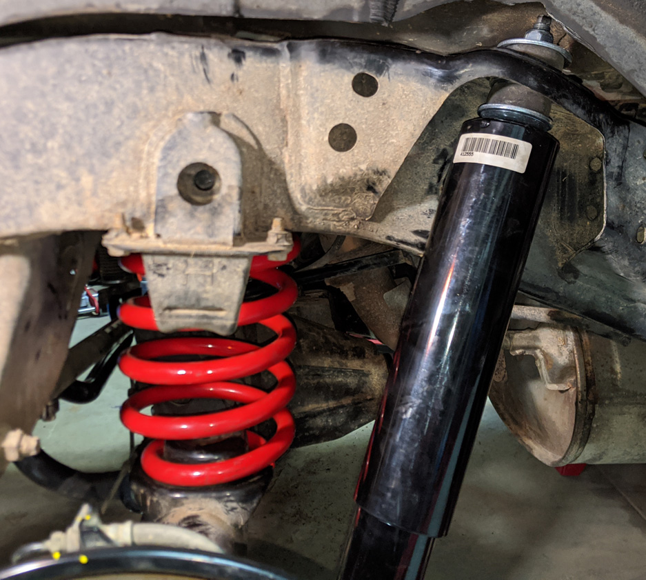

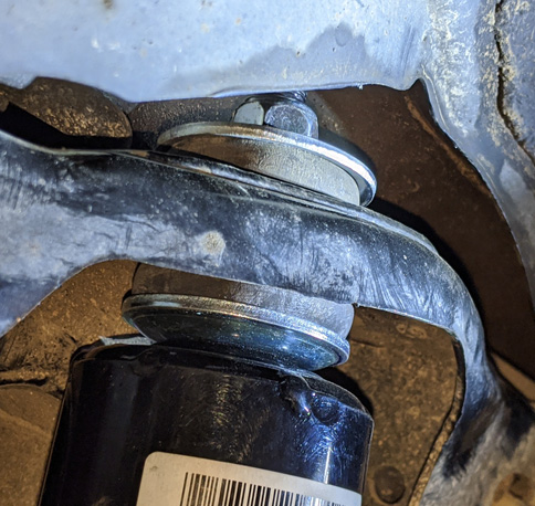

Looks good!! The rear shocks aren't tightened down tight enough though on the top bushings. The bushings should be almost as wide as the washers when sitting at ride height, otherwise the shock could get excess movement.
Thanks. Once the truck was on the ground, I tightened the top shock bolt until the shock body began to spin. Does this look good or do I need to put a strap wrench on the shock and tighten it up some more?
