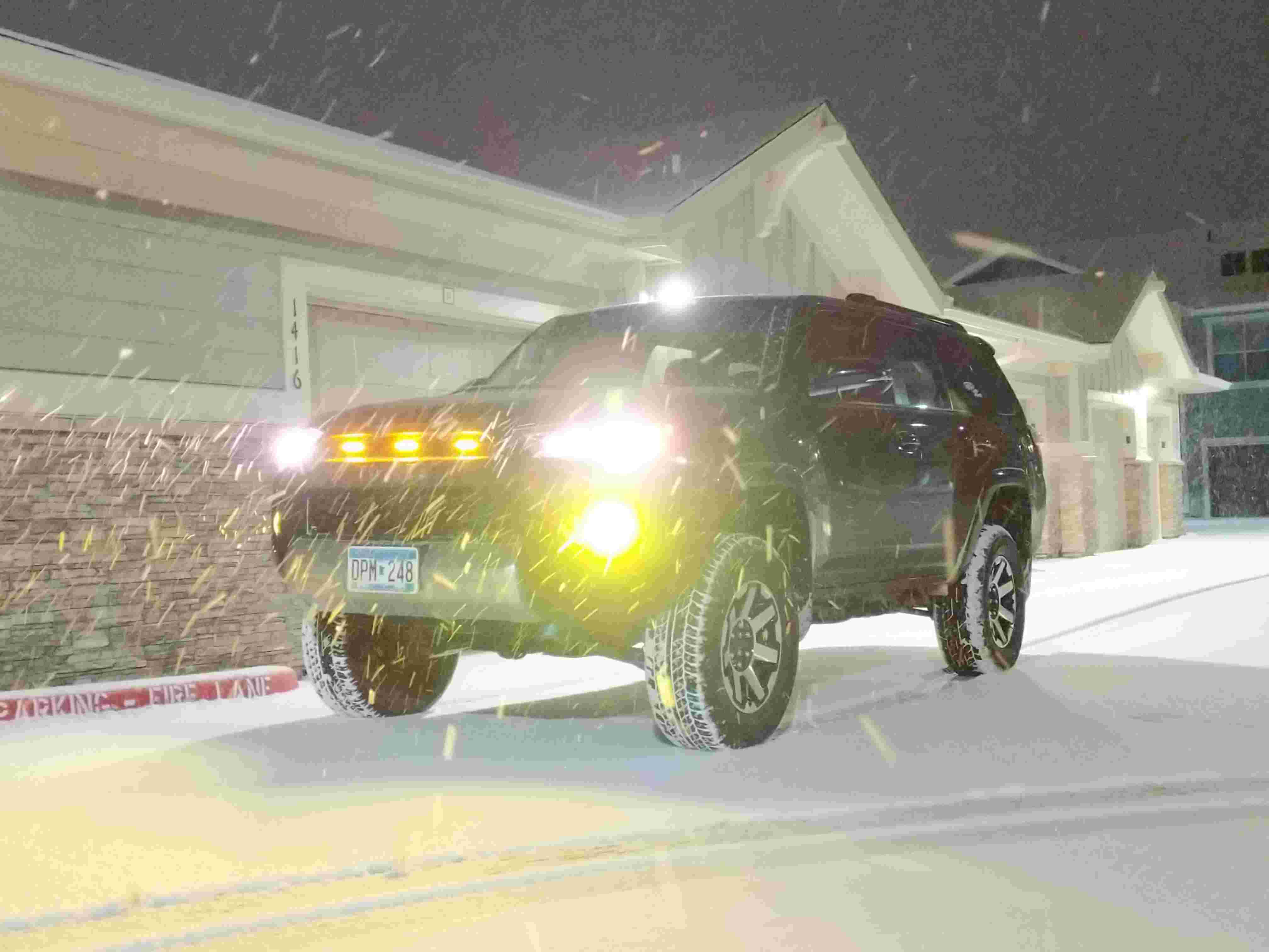

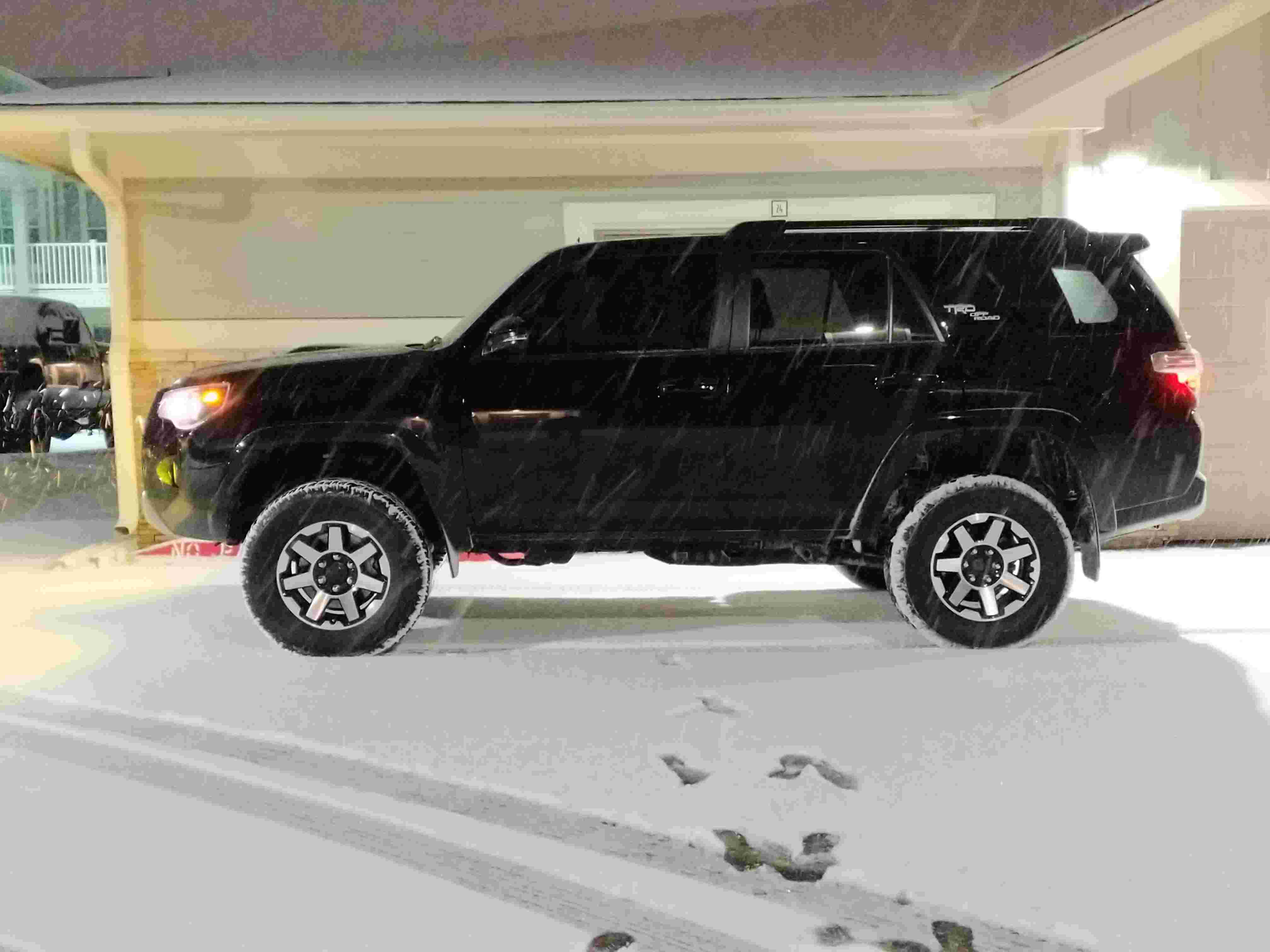

It's totally different. I'm sitting 1-1.25" higher with the Dobinsons kit, so its not really fair to compare the two apples to apples. The most noticeable thing is that the center of gravity is that much higher. I was taking some big curves today at speeds that wouldn't have been concerning previously, but I felt the need to slow down just a bit to stay comfortable. Taller truck, drive slower.
That said, I'd pick the new setup over the old setup.

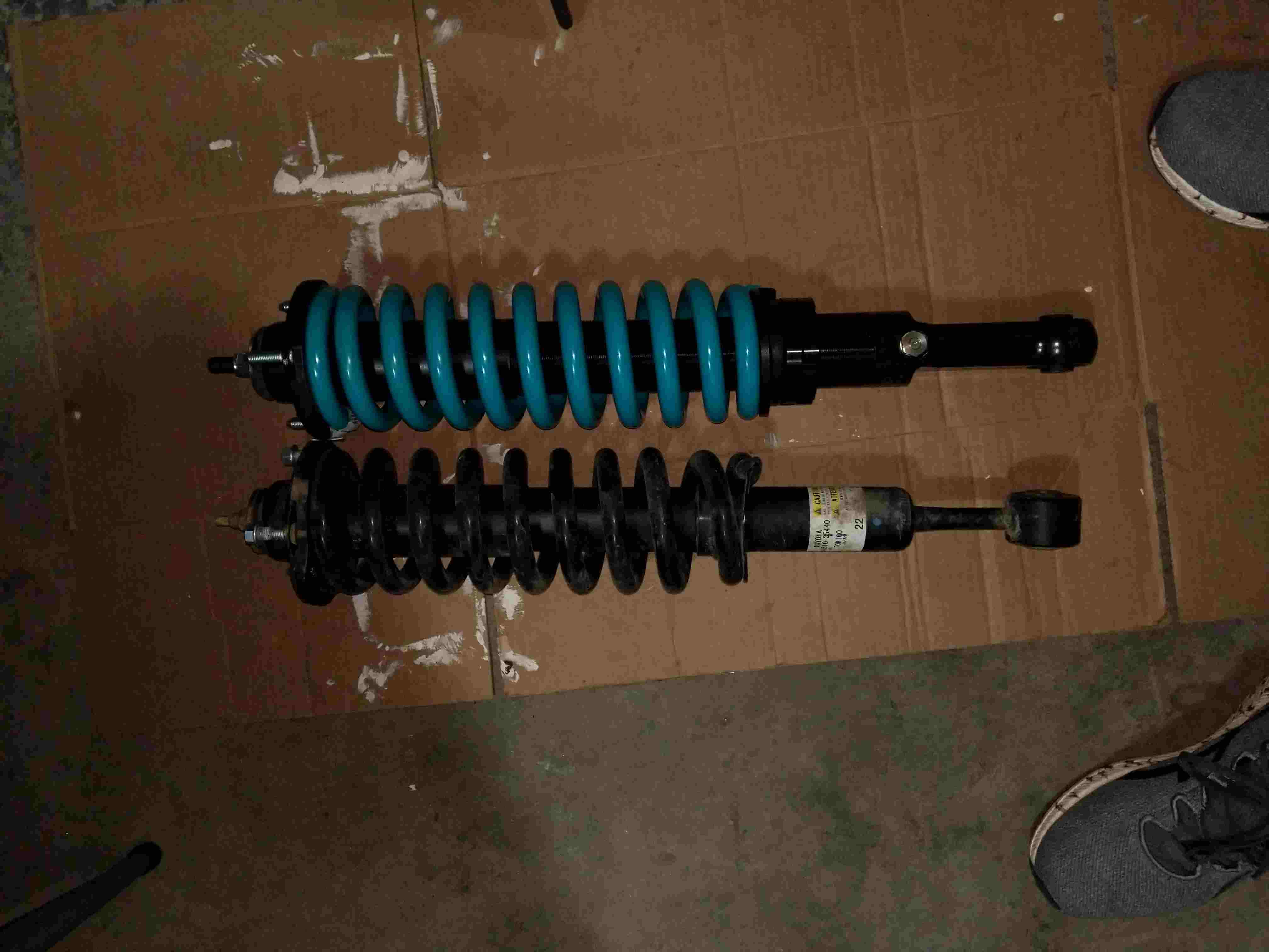

Today I got my IMS set installed! Took about 6.5 hours actual wrenching.
I'll be posting a build thread / full review of them after I get some miles quality seems great!
Went with C302s up front and 725s in back. Now to get the new shoes on.
