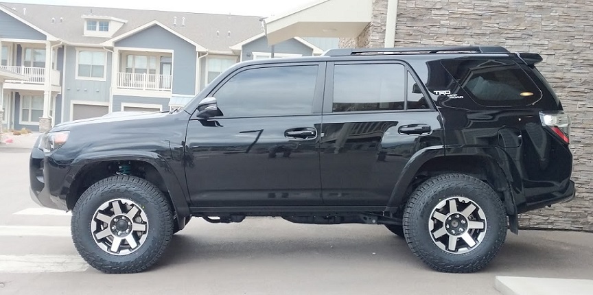

I've got the C302's up front (2.5") and C725's in back (2.0", KDSS version of C325)'s.
Nice rake, drives great. These are installed with the IMS (monotube) shocks.
