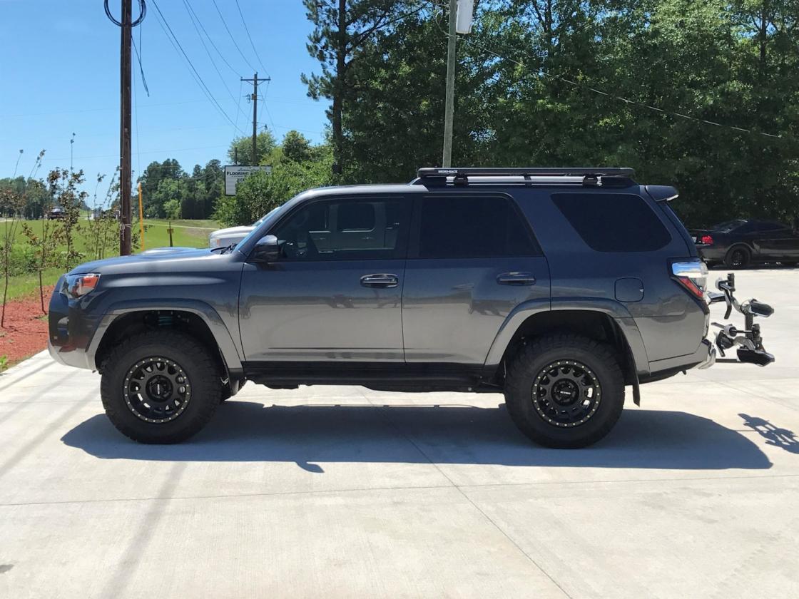

I have a 5th Gen TP that I am looking to put a small lift on. My brother suggested Dobinson, so here I am. Thinking of only going up to 2.5" for right now. I only have some Shrockworks sliders on the way in terms of added weight. I'd like to get the truck level if possible. Also, I think I am going to stick with stock size tires as this is also my daily right now, but am looking into getting it off road more often (possible trip in the Carolina's coming up soon).
Please let me know your thoughts Mike.
Thank you in advance.
Hey man. Ok, so 2.5" up front is the C59-302 coils with stock weight. If you want it dead level, then go with 1" in the rear with C59-599, but don't do that if you'll be loading up often because you'll get reverse rake. Most would do 1.5" rear lift with C59-505 to match the 2.5" front height.

Spoke with Mike (thanks Mike!) and thinking about doing a 2" front and 1" rear lift. Not planning on bumpers or skids, already have sliders.

I'm *this close* to ordering but curious: did anyone that went with a "mild" lift eventually regret not going a bit bigger?
l'm curious as well, looking at the same lift as you paired with the GS59-700 front struts & GS59-705 rear shocks. I only have RSG sliders & TRD front skid.

I don't think it's too common for people to wish they went bigger unless they wanted to put a bigger tire on. Most people that want to stay with a stock-ish size tire would do that smaller lift height.
On the other hand, some people that went with more lift then felt the need to upgrade tires sooner than they wanted to "fill up the wheel wells more".
Here's the 2" front and 1" rear installed

Thanks Mike for the quick response and photo. If those are stock size tires in the photo, then that lift will be perfect for me. I'm on stock
size AT3W Wildpeaks and don't ever plan to go bigger. I think you just sealed the deal for me. Will pm you for T4R members discount code.

Yes those are stock.
