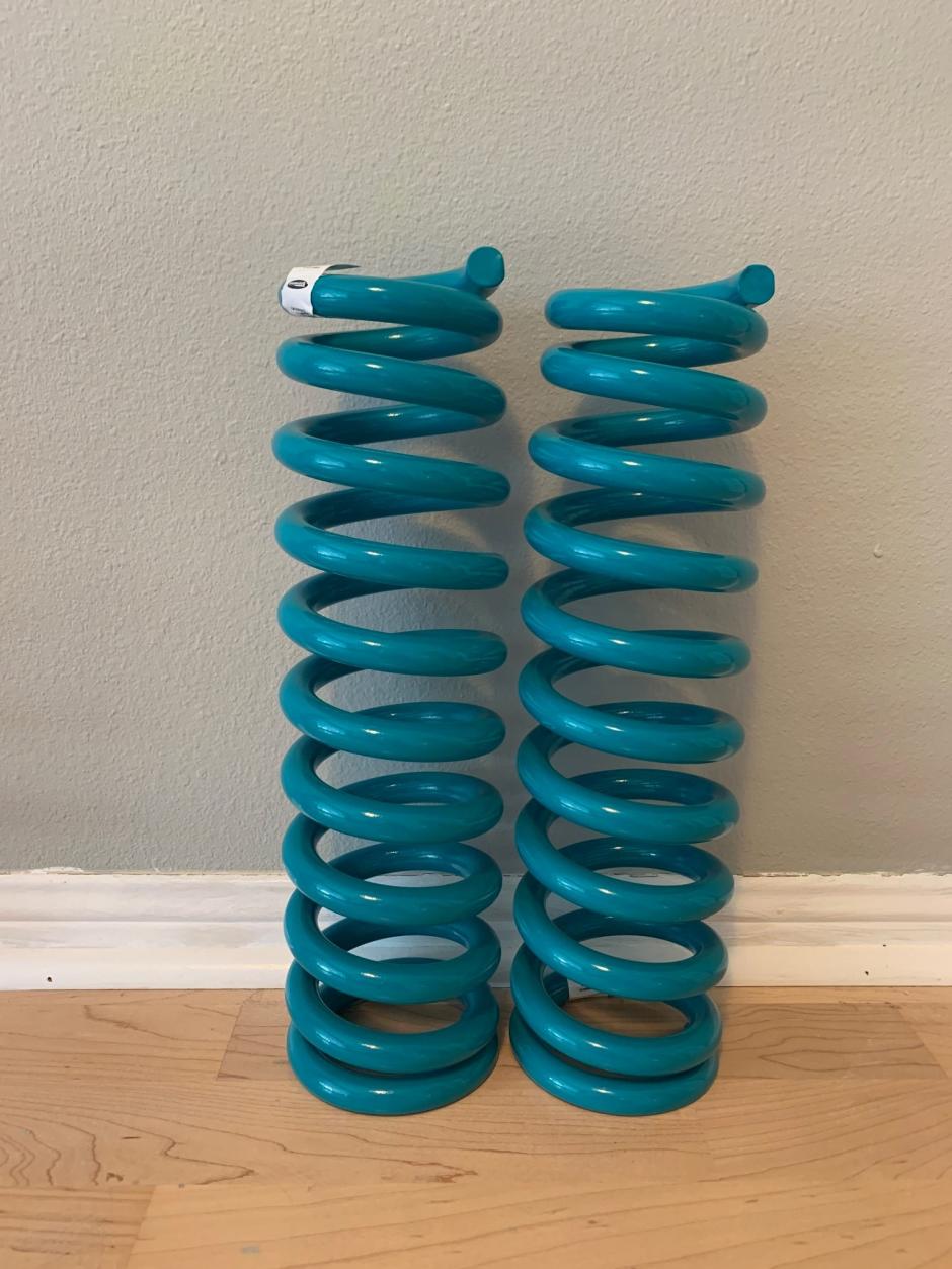

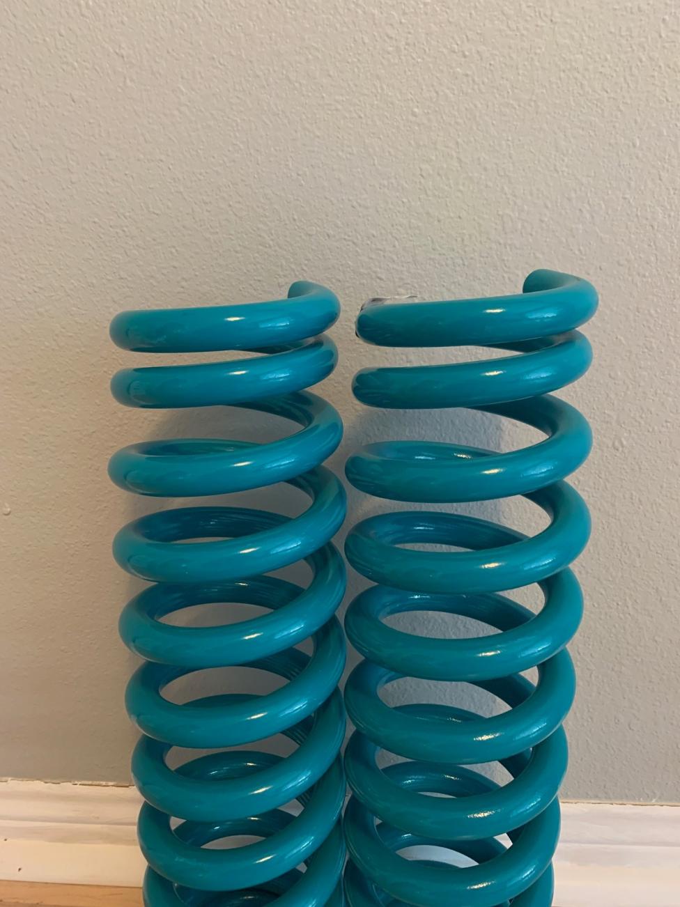

I have been trying to figure out if my coils are normal.. 302's that seem to have a different paint job, one is slightly taller, and they look completely different when looking at a side shot. Anyone have a similar story to share?
