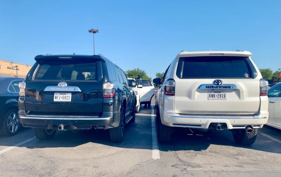

Here is a shot with 250 lbs in the trunk:

Truck looks great! But I wonder why you got now a 0.5" difference at the front? I thought that was for KDSS only?
I have no idea, the OEM coils definitely have a stronger looking driver side coil to compensate so not sure why aftermarket ones don't! Trying to figure out the easiest way to wedge a 1/4" top plate spacer in the front and a 10mm in the rear. The rear coils were such a pain to stuff in and now I gotta go back :(

Have a .5” lean on the driver side, wish I could have known to install 10mm spacers while under there!
Here's your photo, but straightened with the rear windows used as a level.
You don't "have to" add spacers. It won't change the ride at all, it just satisfies your measuring tape.
I honestly want to get over it but it visually leans pretty hard. My girlfriend even pointed it out and she has hardly knows the difference between a tire and a shock.
