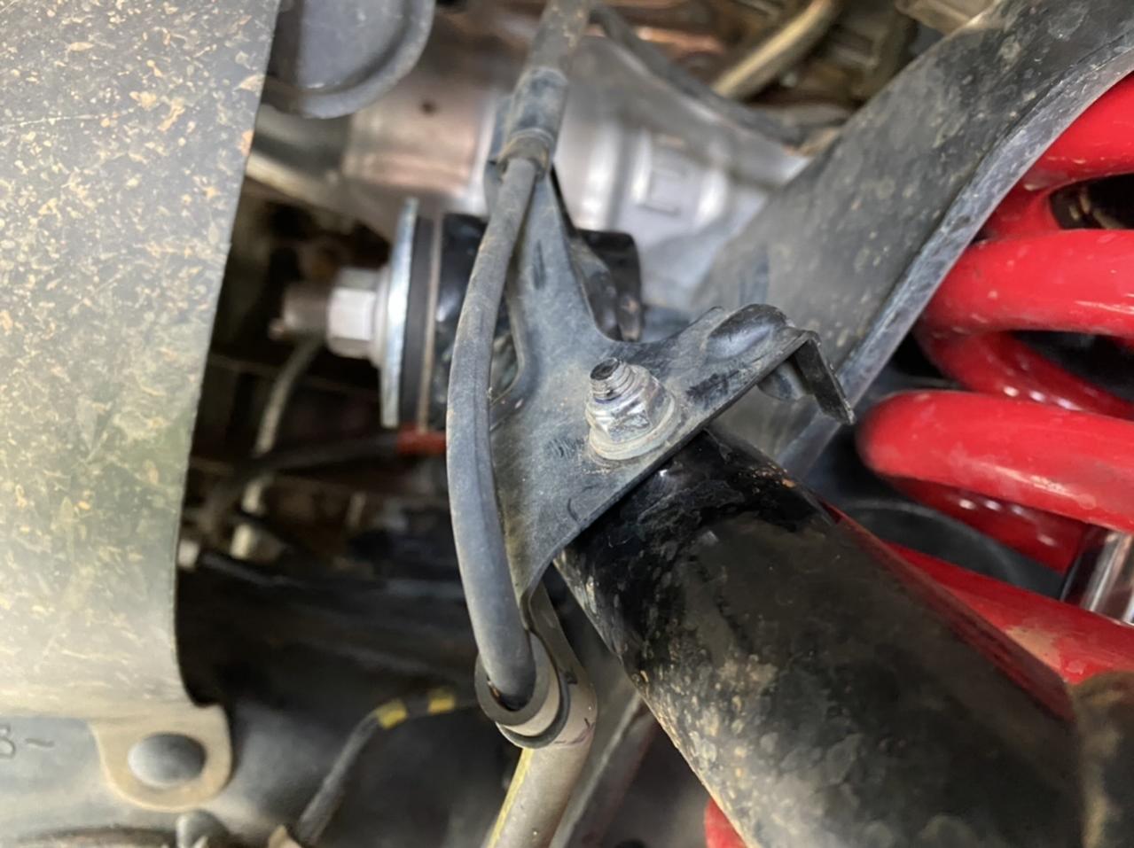

Just installed my UCA's and looking for diections/help with attaching the ABS wire to what is now a post vs a threaded hole?

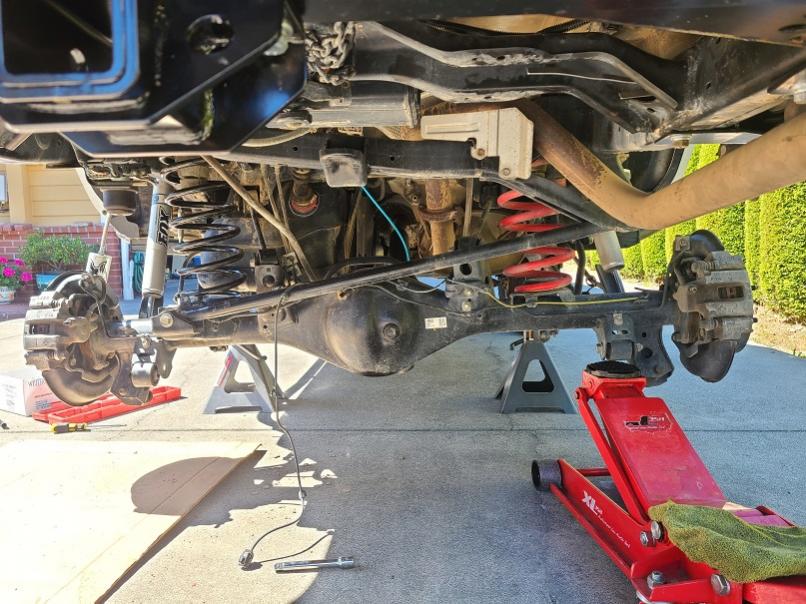

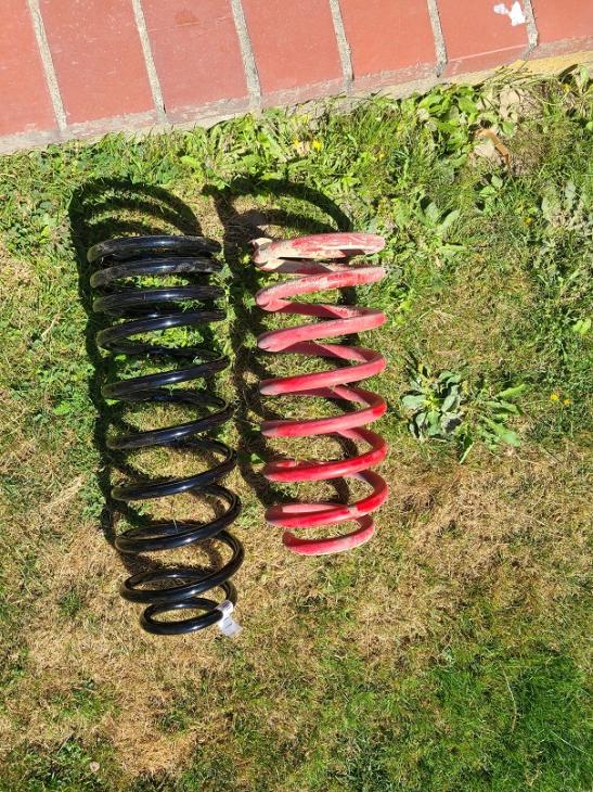

I swapped out my C59-327 for the C59-677v. Boy, it was a pain installing the driver side coil. Unbolted the LCA and had to use spring compressors to get the taller coils in. I added a full steel swing-out bumper (300lbs) recently which caused the C59-327 to sag and thought the 3" 677v would alleviate it. The 677v gave the rear a very marginal lift but rides much smoother over bumps than the 327. I'll probably just lower my front coilovers to even out with the rear. Don't want to think about uninstalling the 677v and and ordering the 701v or 749v coils, at least not yet. I'll probably do full out do a long travel rear the next time I swap coils again. That would mark my 8th time changing out my rear coils lol.

No not yet. Honestly I haven't opened the little bag. There's 8 pieces in the bag. I watched Mike's control arm video but he skipped over the abs line quickly.

I’m not sure how much if at all this picture will help but here is now line is attached. I had mine installed by a very well known shop in my area.
Looks like just they attached it with one of the nuts in your picture to me.

Yes this is how it goes on. I don't know why there was that little bolt in that other bag. From memory it was just washers and nuts before.
