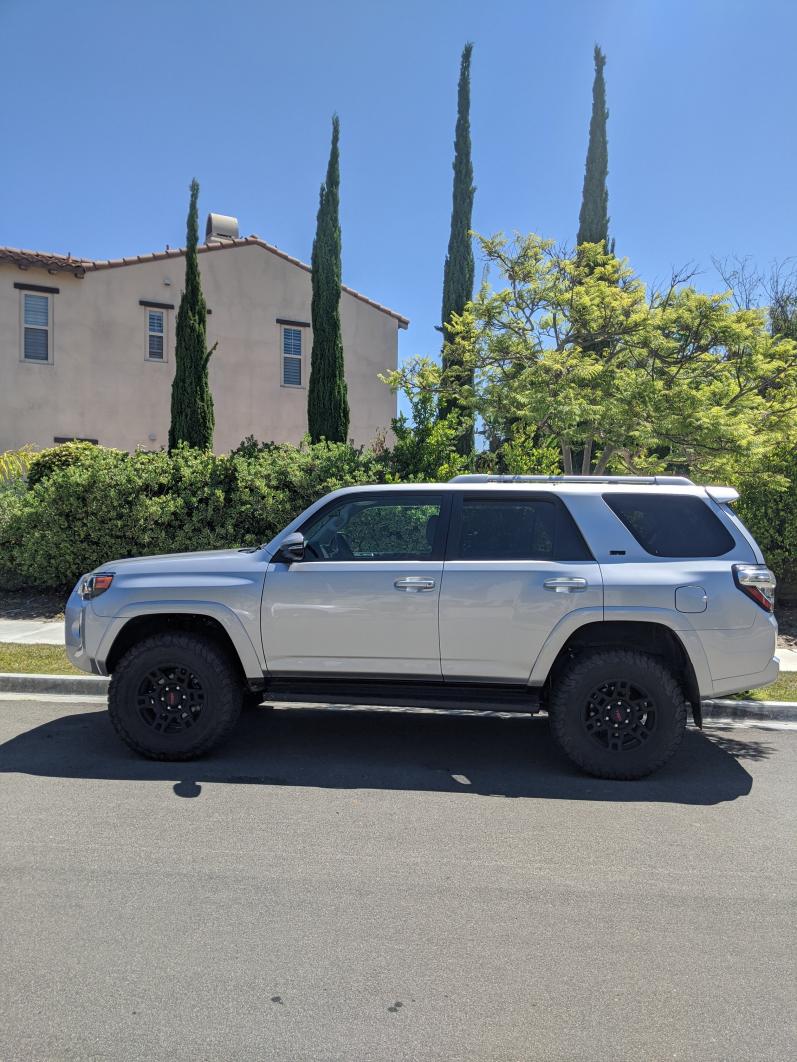

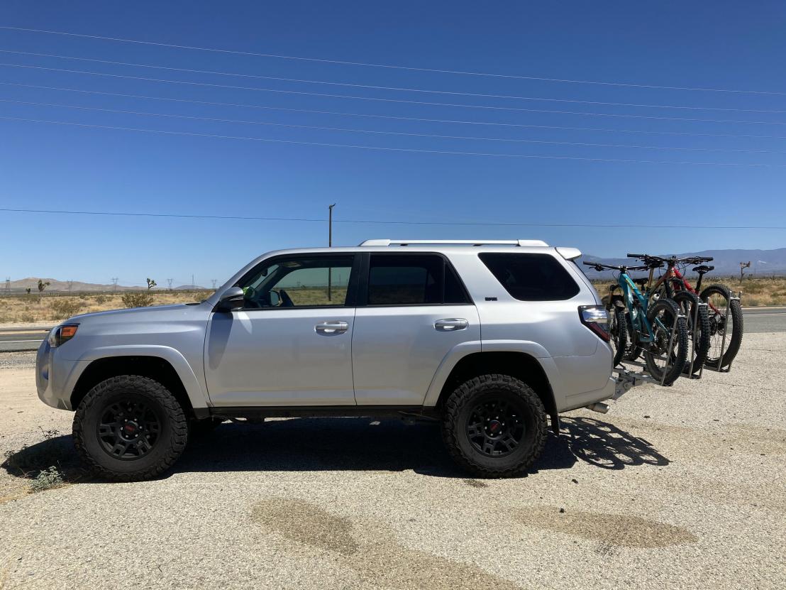

Just got back from first trip with new suspension so figured I was post a few pics(sorry about the quality)
1st one is unloaded
2nd has medium load(bikes and clothing but no camping gear)
Did some 4 out of 10 offroading and didnt hear any crunching noises so seems like the additional travel helped out.
