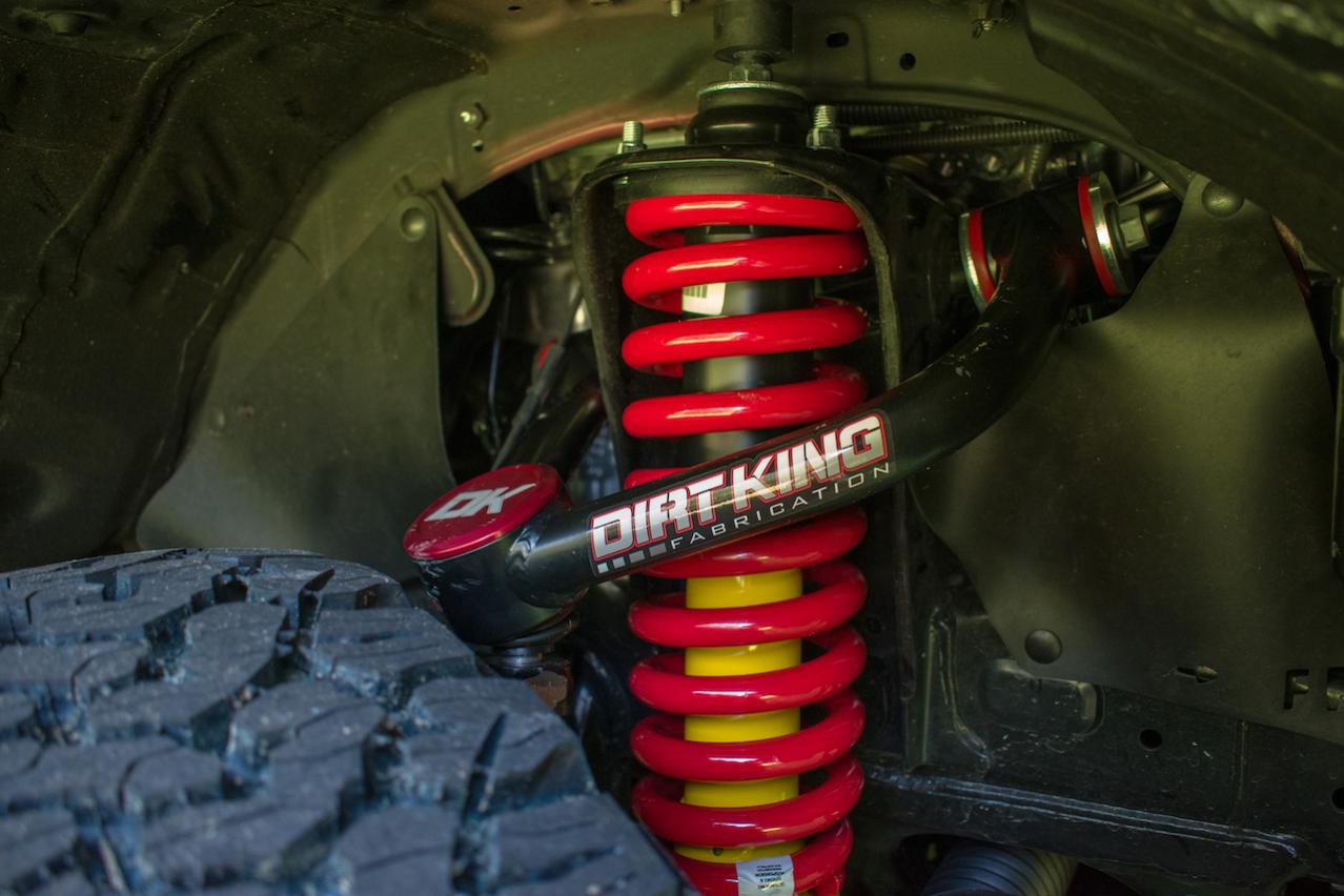

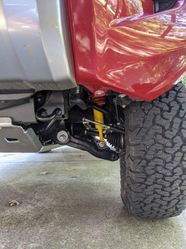

Finally had my lift put on. Came out great! Thanks again Mike for all the help with the ordering process and directing me to these dirt king UCA's!
Front: GS59-574's w/C59-302
Diff Drop
Dirt King ball joint UCA's
Rear: GS59-705'S w/ C59-325
Stock weight for now... will be ordering slimline bumper soon. Anyone have comments for my current CV angles? :behindsofa: Lift was just put on so hoping it settles.

That's great man, glad you got it all installed!!
Definitely take it for a solid drive, find some speed bumps, railroad tracks, or something where you can cycle the suspension a lot to get it to break in and settle.
