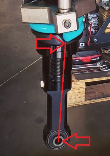

The front adjustment is a 1:2 ratio, so adding 1/4" of preload will gain 1/2" of lift at the wheel, so it doesn't need to go up very much to add additional height.
Here's the measurement again of how to see the 213mm. I had another guy just this morning who measured from the top of the adjuster down, not from the notch where the coil sits, so he ended up with more lift than he should have.

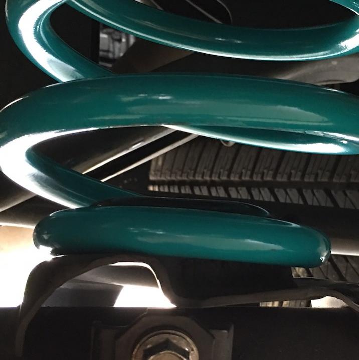

And the 2nd photo shows the rear coils not seated properly, this adds easily 1/2" to the lift height, so that's something else worth checking on the rear.
Thank you for the photos. I’m 100% sure the front is measured correctly. I’m 99% sure the rear is seated properly but will crawl under tonight and verify
It’s getting pulled apart Saturday so I’ll be able to take full spring measurements at that time.
