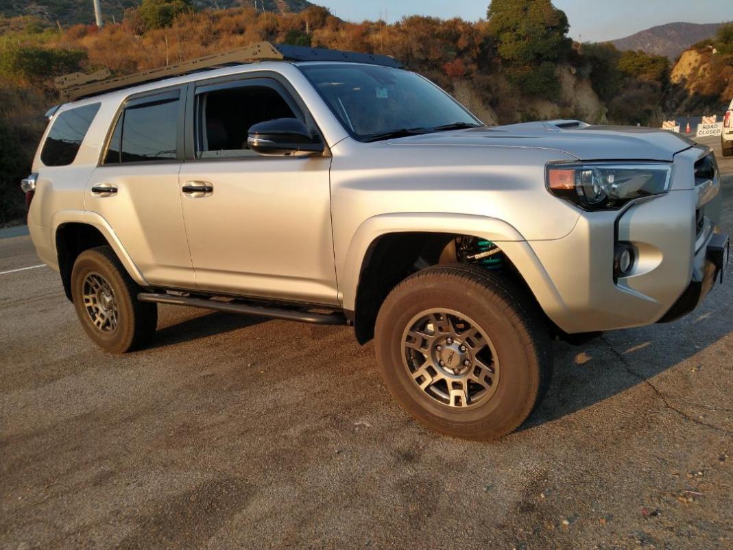

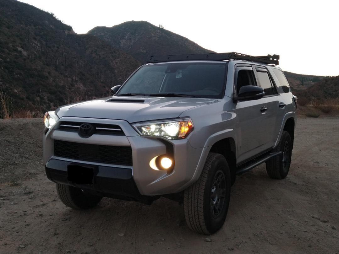

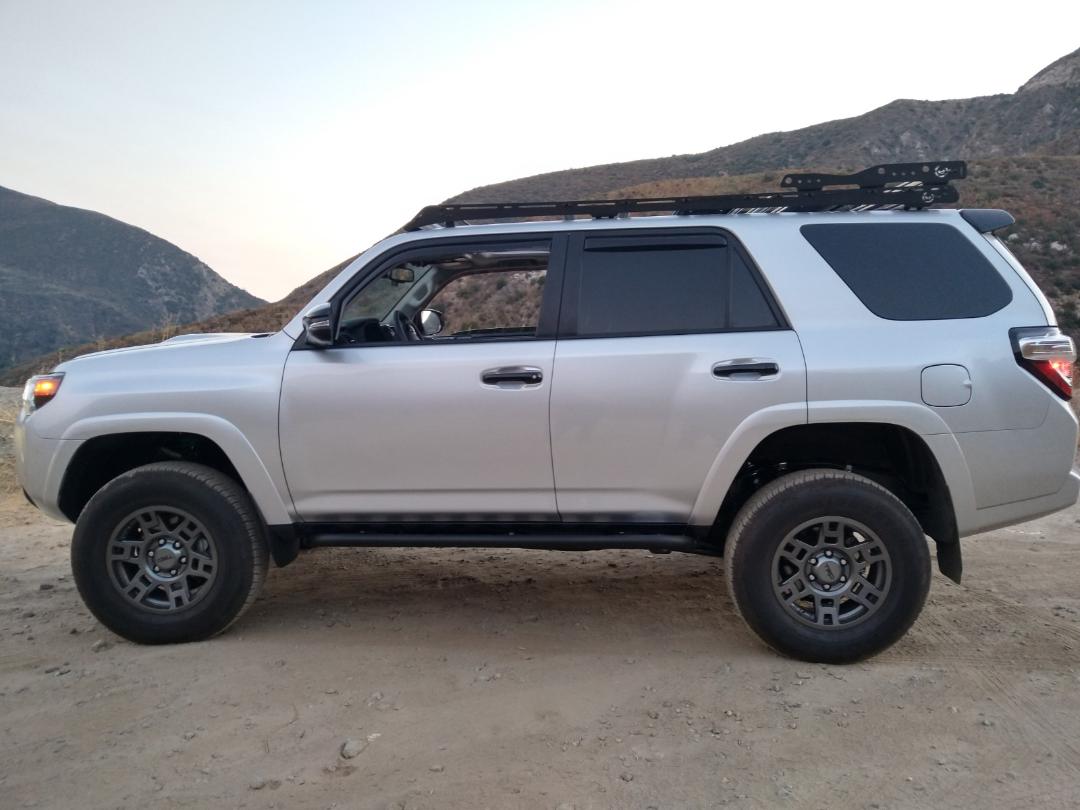

Looks good! What height springs did you go with front and rear? Looks like 265 size tire? I am looking at this exact lift. If you have any side shots etc of the stance on the ground I would greatly appreciate it. Thanks.
At the front, I have 302, rear 505, for a total gain of roughly 2.5" front and 1.5" rear. Yes, I'm still on 265s, provably upsizing to 285s next year.
Here is an (almost) side shot. Any other questions let me know, happy to help.
I installed my dobinsons c59-325 coils in the rear but I am getting 24” from center of hub cap to fender on drivers side rear which is 2 inches of lift and 25” on the passenger rear which is 3”. Not sure what’s going on both coils had the c59-325 tag on them. Double and triple check they are in correct. Wondering if I should put a 1/2” spacer on above coil on driver side rear. Fronts are within a 1/4” of each other
My 325’s put me at 23.5 on the drivers side and 24.25 on passenger side with third row seating. I agree that its a bit too much of a lift. I was at 21.5 on both sides before lift so +2 inches on driver side and +2.75 on passenger. I put a 15mm trim packer on the driver side and now its 24.0.
Now I have about the same rake as stock, but whatever lol.

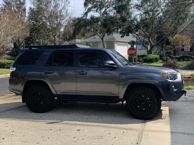

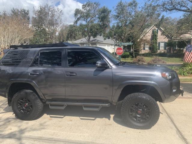

Lift installed.
Dobinsons UCA
Dobinsons struts and shocks
59-302/59-574 front
59-325/59-701 rear
Dobinsons Diff Drop Kit
RCI skid
Fumota Valve
Completed my lift. Did it myself with a buddy helping. We learned a lot. Wasn’t too technically difficult. Ride is greatly improved. Thing is a Beast! Currently 4 inches over pre lift. I expect it will settle.
